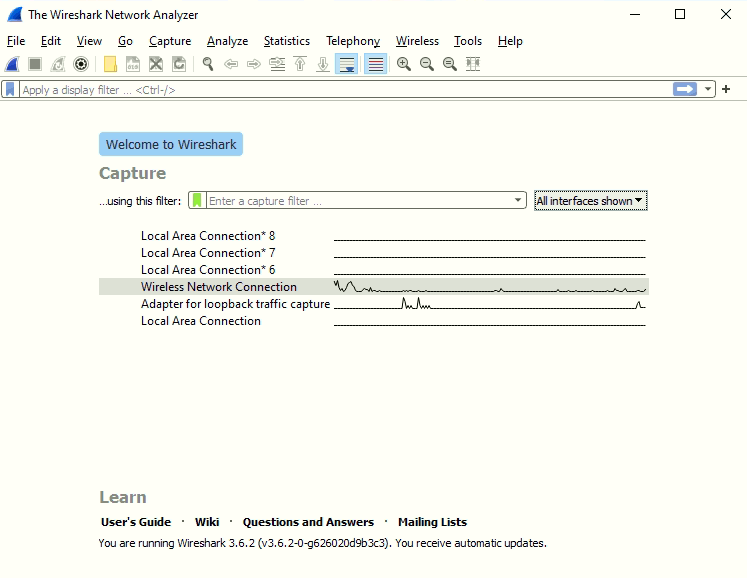

0693W00000JPgalQAD.pngHello TDK,
I downloaded the wireshark analyzer but when i opening that in the main window list its not showing the usbCAP1 for capturing the packet
can you suggest me the steps for that or have any method to add that.
February 14, 2022
Did you install PCAP?
https://desowin.org/usbpcap/
Could also try "USB Monitor Pro" which worked for me.
