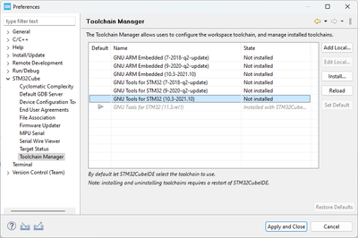

Hello everyone,
I'm currently working with the STM32CubeIDE and I'm encountering an error after the new Update 1.13.1.
After using the printf function the following function in the newlib_lock_glue.c  throws me into the Error_Handler in the main.c, after checking the lock for a NULL value.
__retarget_lock_acquire_recursive(_LOCK_T lock)
 STM32_LOCK_BLOCK_IF_NULL_ARGUMENT(lock); //This line results in the Error_Handler
 stm32_lock_acquire(STM32_LOCK_PARAMETER(lock));
This behaviour just started after the version upgrade from 1.12.1 to 1.13.1 of the IDE.
I tried to change the MCU Toolchain settings to the older GNU Tools version (10.3.-2021.10)
now printf works just fine, but if I use the new GNU Tools version (11.3.rel1), which is
the new default setting of the IDE im encountering said Error.
How can this be avoided in the new version of the GNU Tools?
Maybe someone can help me with this issue.
Please inform me if you need further information.
Thanks in advance

This is a bug in newlib that has since been fixed. Initialization of the lock in each standard stream was unintentionally removed during refactoring. It looks like ST noticed it a few weeks after the upstream 11.3.Rel1 release came out and submitted a patch to the newlib project. Unfortunately they did not include the fix in their newlib build nor add it to their list of known issues. You can verify by checking the disassembly of the std function. It doesn't call anything besides memset.
Here's a workaround:
#include <stdio.h>
#include <sys/lock.h>
// Insert this somewhere before first use of standard streams. One of the the
// user code sections near the top of main is a good place.
#if __NEWLIB__ == 4 && __NEWLIB_MINOR__ == 2 && __NEWLIB_PATCHLEVEL__ == 0 && !defined(__SINGLE_THREAD__)
  // The version of newlib bundled with GNU Tools for STM32 11.3.rel1 fails to
  // initialize the locks in the standard streams.
  if (!stdin->_lock)
      __lock_init_recursive(stdin->_lock);
  if (!stdout->_lock)
      __lock_init_recursive(stdout->_lock);
  if (!stderr->_lock)
    __lock_init_recursive(stderr->_lock);
#endif
Also, if you're using STM32_THREAD_SAFE_STRATEGY == 4, see the link that Piranha posted. It's not the problem here, but it is a problem. If you aren't using anything that requires a lock from an ISR, which you shouldn't be, switching to #5 is the easiest way to resolve it.

Can also just install the previous toolchain easily enough...
Installing GNU Tools for STM32 version 10.3 worked perfectly for me. Printf stopped calling the error handler. Thanks!

In the recent version of Cube IDE 1.13.2 the issue seems to be resolved for good.
