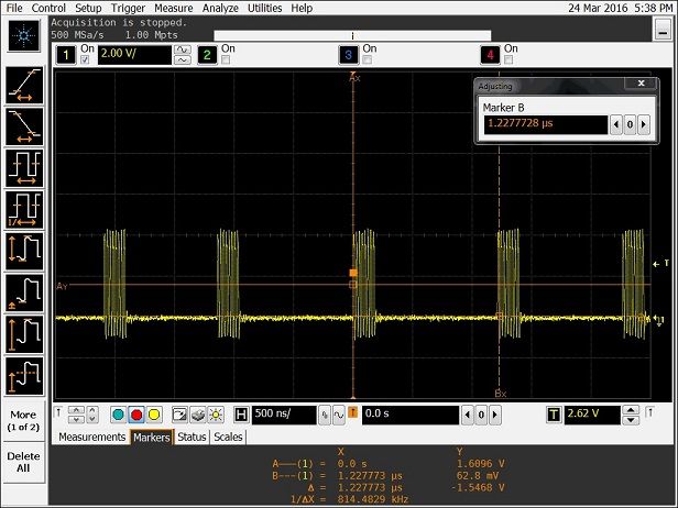

I have a stm32f439 board with a 128MB SPI flash in hand, this board also has a 32MB external RAM. My target is to copy the large scale data from flash to RAM.
So far I can read the data to RAM from flash by polling, however, the speed is quite limited. My SPI speed is set 42MHz, but the final flash read speed is only <8Mbps. The following figure shows the actual test result. Obviously there is a big interval between 2 SPI read, which waste quite a lot time, and so I want to reduce the interval between 2 SPI read. However, I don't know where can I do that modification.  I'm using ST's HAL driver for all SPI's operation, so far I'm always using the function ''HAL_SPI_TransmitReceive()'' to keep polling/receiving data. Still not sure if DMA receiving can improve it or not(principlly I don't think so because even in polling mode I do nothing but checking status and transceiving). For your convenience, I also put the ST's source code file[stm32f4xx_hal_spi.c] here.0690X000006038HQAQ.jpg

Posted on March 24, 2016 at 12:16
Yes, it seems to be burning a hundred or so machine cycles between bytes which is slow even for HAL
Pretty sure I could saturate with DMA.

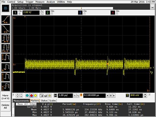

jeff23
Posted on March 29, 2016 at 10:29
Put my SPI clock waveform here, The whole process seems OK, but there is data error. I don't have any good way for next...
