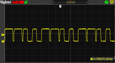

I'm trying to use DMA in circular mode to modify the duty cycle of a PWM output. Ultimately, I plan to use it to communicate with WS2812B chips (like others have done with the STM32F4 chips). However, in my early tests I've noticed that it seems to send two pulses per buffer value.
For a simple example (full code at the end):
#define BUFFER_SIZE 2
uint16_t buffer[BUFFER_SIZE];
buffer[0] = htim3.Init.Period * .5; // 50%
buffer[1] = htim3.Init.Period * .9; // 90%
HAL_TIM_PWM_Start_DMA(&htim3, TIM_CHANNEL_1, (uint32_t*)buffer, BUFFER_SIZE);
There are 2 items in the buffer, one set at 50% duty cycle and the other at 90%. When circular mode is enabled, I would expect to see the PWM pulse to be alternating between the two. However, I see 2 pulses at 50% followed by 2 at 90%, and so on.
I'm sure I'm missing something elementary here. How do I get the pulses to alternate 50%, 90%, 50%, etc?

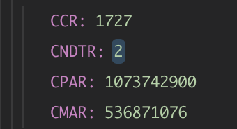

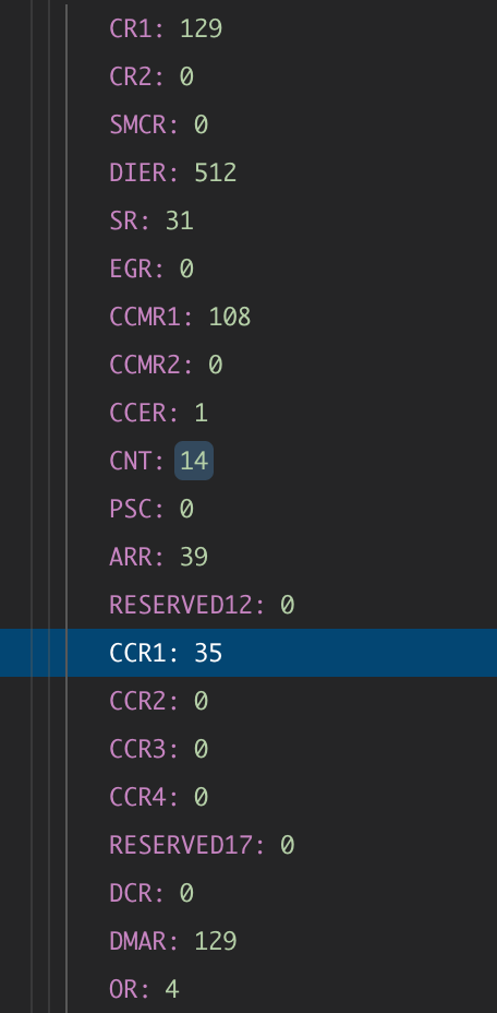

Some register values and a few more thoughts/questions:
Some of the TIM3 registers, using GDB:
I paused the application several times and can confirm the correct number is being set to CCR1. I cannot track the the value in real-time, since it's being transferred outside of CPU operations.
I'm not sure which DMA registers would help us here, but here are some of them:

Another thought. Looking at the timer registers, DIER has UDE (bit 8 - Update DMA request enable) set to 0. This could be affecting the request event, even though tthe CC1DE (bit 9 - Capture/Compare 1 DMA request enable) is enabled.

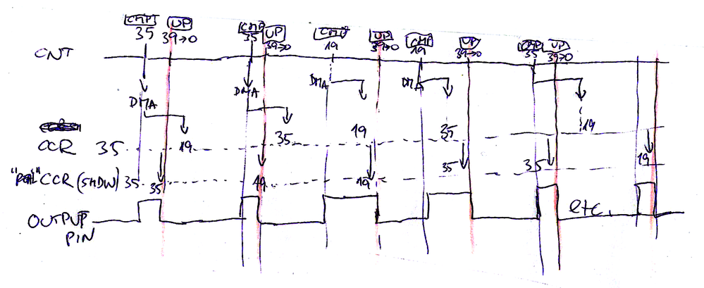

The problem is a combination of
  • CCRx being preloaded, i.e. value written to CCRx gets "active" (in ST lingo, gets copied into the shadow register, where the shadow is the "acting" register, not directly visible to the programmer but governing the behaviour) only after the next Update event (that's when CNT==ARR and then rolls over to zero) - this is witnessed by TIMx_CCMR1.OC1PE = 1 (btw. OC1FE is irrelevant here; it's a marginal feature only when the timer is triggered from some other signal, this is not the case)
  • DMA is driven from CC event (TIMx_DIER.CC1DE = 1)
  • timing is too tight, i.e. with the CC set to 90%, at the time when DMA finishes the nest Update has already passed - DMA takes maybe a dozen cycles depending on several different circumstances, from the trigger to writing to the target - here, at the 90% there are only 4 cycles, that's too few - read AN2548 for the painful details
I've made this back of the envelope drawing, but these things tend to get much clearer if *you* make this or similar drawing:
The remedy is simple, don't trigger DMA from CC, but from Update, i.e. don't set TIMx_DIER.CC1DE, but TIMx_DIER.UDE.
It maybe will then also be a different channel in DMA and different setting in its triggers-inputs-mux, look it up in the DMA chapter).
I don't Cube.
