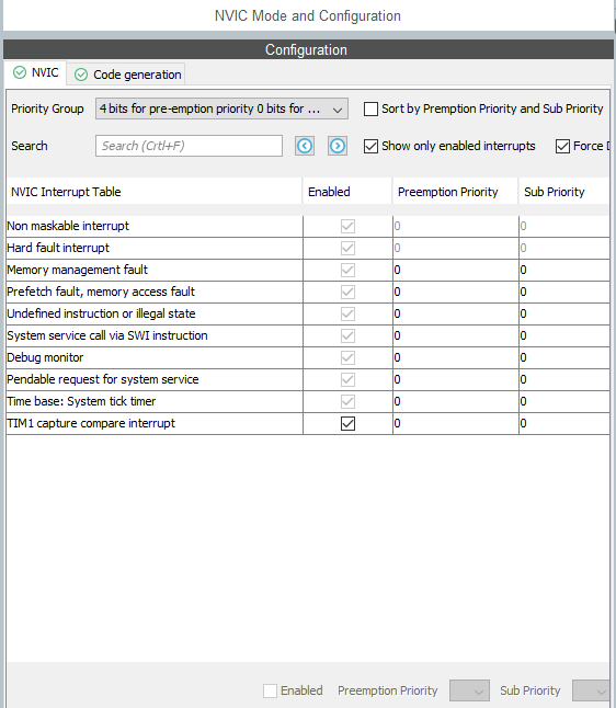

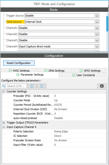

How can I make sure the timer IC is ready? The only line of code I have outside of the default and ISR is HAL_TIM_IC_Start_IT(&htim1, TIM_CHANNEL_4) which I call in the main function before the loop. Here are my timer 1 settings:

No. Must be something else going on. Perhaps the system is busy in another interrupt.
6ms at 80 MHz is 480000 ticks. It must be doing something else during that time.

Using the slave mode path, what type of Trigger Output (TRGO) should be used for an input capture timer? The only options are output capture ones.
It looks like "Compare Pulse (OC1)" is the correct selection here, but is only available on channel 1, at least on the chip I have up currently.
waclawek.jan
Use "Compare Pulse" (0b11 in TIMx_CR2.MMS). It's incredibly badly named, but it sets TRGO to output a pulse whenever CC1IF is set, whether it's because of Input Capture or Output Compare. Only CH1 can be used for this purpose.
But you don't need to do that. As TDK said above, set up the timer for the PWM output but don't enable it in TIMx_CR1.CEN and connect the input signal to a channel which can trigger the Slave-mode controller set to Trigger mode (again, only CH1 and CH2 can be used). Set a third channel to Output Compare, Active on Match, and that will serve you as the pin which you want to set when the edge is detected.
