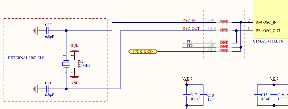

I'm planning to build a custom board with the STM32G431KB on it and it needs to be programmed via USB.
So I bought NUCLEO-G431KB board and soldered a USB cable on it.
- Red on Vin
- Black on GND
- White on PA11 USB_DM
- Green on PA12 USB_DP
I also hooked PB8-boot to 3.3V when I plug the USB cable in
In Cube Programmer it doesn't show up in the DFU list.
I also don't hear the usb in/out sound on Windows.
PB8 also has a LD2 led hooked to it pulled low with a pull down.
In the DFU documentation they talk about different stuf f that has to be configured right, USB active, HSI, etc. But a bootloader is always using default config right?
In my opinion all the stuff I set in the .ioc file is for flash memory after you left the bootloader?
Am I doing something fundamentally wrong here?
I know the soldered USB cable will not have proper differential pairs, but out of a 100 resets I was hoping at least one DFU detect would succeed so I can continue my schematic.
DFU on the Nucleo 144 board that has a proper soldered DFU socket works.
So I assume it is my setup on the Nucleo 32 board, not CubeProgrammer or driver

The USB DFU bootloader requires a stable clock, typically provided by the HSE or an external clock source. You can find these details in "1 Bootloader code sequence" in AN3156.
By default, this board has no clock input on PF0. You'll need to close SB13 in order to use the 8MHz clock output by the ST-Link chip.

No luck so far.
- I first soldered SB9 and SB10, but then I realized this is 24MHz.
- De-soldered SB9 & SB10 and soldered SB13
- Connected st-link usb to get power and clock
- Set PB0 high and hit reset button
- No DFU detect
When I pullup USB_DP line I here the Windows 10 USB connect sound but get a warning it has not properly recognize the device

‎2020-04-01 11:24 AM
Ok I got something going.
When I connect via ST-link I discovered that option byte nSWBOOT0 was unchecked and never was listening to PB8-boot.
Is this unchecked by default? In that case I can never DFU bootload a factory fresh microcontroller.
Or is it unchecked when once you manage to connect via ST-Link before?
