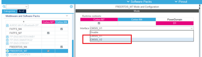

In the tutorial mentioned above CMSIS_V1 is used, but for the MODBUS library which I want to use CMSIS_V2 is required ( Modbus-STM32-HAL-FreeRTOS ).
Now if I simply change CMSIS to V2, i get the error:

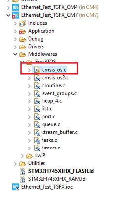

As I don't have your TouchGFX project I cannot test it but you can remove cmsis_os.c from the project tree.
cmsis_os2.c is already added..

make: *** No rule to make target '.../Ethernet_Test_TGFX/Middlewares/Third_Party/FreeRTOS/Source/CMSIS_RTOS/cmsis_os.c', needed by 'Middlewares/FreeRTOS/cmsis_os.o'. Stop.
cmsis_os.c is for CMSIS_V1, you need to use cmsis_os2.c and port your CMSIS V1 to CMSIS V2

The error was caused by setting CMSIS setting from V1 to V2 in CubeMX, so i need to change something else, but what and where?
PS: This is NOT an online support (https://ols.st.com) but a collaborative space. So please be polite in your reply. Otherwise, it will be reported as inappropriate and you will be permanently blacklisted from my help/support.
Yeah, that did the trick, thanks a lot!
