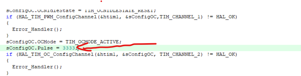

i am using stm32f446re. i am using timer in synchronization mode one timer triggers another timer so my query is master timers triggers slave timer to generate another timer pwm so that triggers value i want to control so what hal function i use to control this triggers value while code is running then i want to change this trigger value.
here is an example what i want-
- lets say master generate 50% duty cycle pwm so when master is 25% of its pwm then slave gets trigger to generate its own pwm.so i want to control this 25% value. so what HAL function i use to control this value while code is running.

2024-03-30 1:45 AM
If you use Trigger mode of slave-mode controller in slave timer, that only sets TIMx_CR1.CEN, so it does nothing if TIMx_CR1.CEN is already set (i.e. if the slave timer is running continuously). If that's the case, you have to clear TIMx_CR1.CEN in slave when you change the compare value in master.

2024-04-18 11:27 PM
thanks for your reply....
i know this function already but this not what i am asking i want to change that trigger value not width of any pwm.that function you provided is used for changing the width of pwm. i want to change that trriger value which activate second slave timer to turn on. please read my given example in my question....
2024-04-18 11:37 PM
see in this photo i want to change this arrow mark value.. tell which hal macro i use to change it
2024-04-19 12:54 AM - edited 2024-04-19 12:59 AM
I don't use Cube/HAL.
You can look at the HAL_TIM_OC_ConfigChannel() function's source, what does it do with that value, but it probably simply stores it into TIMx_CCRx.
The macro @Sarra.S posted looks very much like it does exactly this.
In your original question, TIMx_CCRx of master provides the point, where it generates TRGO which is then input as TRGI to slave. However, as I've said, if you use Trigger mode of the Slave-mode controller of the slave timer, it sets its TIMx_CR1.CEN only once, so subsequent TRGI from master are ignored.You have to clear slave's TIMx_CR1.CEN (stop the slave counter) to have it triggered from the master (with already adjusted TIMx_CCRx which provides the moment of trigger) again.
