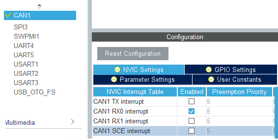

The code above is similar to my code.
I'm also working on the STM32CubeMX FW_L4 v1.5.1 library on the Nucleo-L476RG board,
and there is a similar phenomenon that doesn't work like you,
so please let me know when the problem is solved.
If you want to use CAN RX interrupt, add the code below.​
HAL_CAN_Start(&hcan);
HAL_CAN_ActivateNotification(&hcan,
 CAN_IT_ERROR|CAN_IT_LAST_ERROR_CODE|CAN_IT_BUSOFF|CAN_IT_ERROR_PASSIVE|CAN_IT_ERROR_WARNING|
 CAN_IT_RX_FIFO0_MSG_PENDING|CAN_IT_RX_FIFO1_MSG_PENDING|
 CAN_IT_RX_FIFO0_OVERRUN|CAN_IT_RX_FIFO0_FULL|CAN_IT_RX_FIFO0_MSG_PENDING|
 CAN_IT_TX_MAILBOX_EMPTY);
