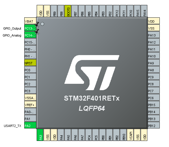

I've two kind of STM32CubeMX project : one for a STM32F401RE MCU and one for STM32F412CE. The fact is there is no, for example, PC3 pin on STM32F412CE MCU unlike on STM32F401RE MCU. (but STM32F412CE MCU has got a PC15 pin)
it looks like that there is no macro that takes into account that PC3 is not present on STM32F412CE.

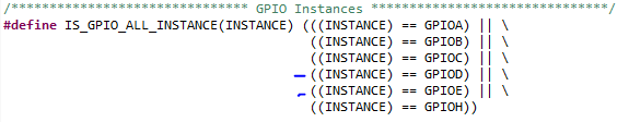

Well, it seems that we can't completely trust IS_GPIO_PIN or IS_GPIO_ALL_INSTANCE; see :
Here is my .ioc for the STM32F401RE project, as you can see there is no E or D port :
but if we check the stm32f401xe.h file where GPIO are defined, we see that PORTS E and D are defined :
and here is IS_GPIO_ALL_INSTANCE macro definition :
Did i miss something ? or does it just suck ?

waclawek.jan
There are no distinct headers per package, so they inevitably cover the largest package in the given subfamily.
Ok, that what i was thinking. Thank you !
