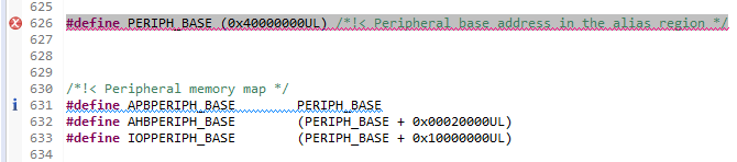

Hi, i'm doing a code in C for stm32 with LoRa-02, and i came across a weird error.
WNowa.1
error:
expected declaration specifiers or '...' before '(' token
A part of a code:
txt:
define PERIPH_BASE (0x40000000UL) /*!< Peripheral base address in the alias region */
/*!< Peripheral memory map */
#define APBPERIPH_BASE        PERIPH_BASE
#define AHBPERIPH_BASE        (PERIPH_BASE + 0x00020000UL)
#define IOPPERIPH_BASE        (PERIPH_BASE + 0x10000000UL)
I'm useing a sts library for SX1278. I don't understand whats wrong with the definition. It seems like the declaration sequence is done correctly, maybe something with nested definitions or something, i don't know. Also when i copypaste this fragment of code into new project, error disapears.
Sorry for my bad london, thx for help :v
edit 1: deleted
edit 2:
My code (main.c) is just a few #include and an endless loop.
Part of a code where PERIPH_BASE is used. It's hal rcc header file:

 edit 3:
C:/Users/Wojtek/workspace/RA_B-L072Z-LRWAN1/inc/mlm32l0xx_hw_conf.h:120:42: note: in expansion of macro 'USART2'
 #define USARTx                           USART2
C:/Users/Wojtek/workspace/RA_B-L072Z-LRWAN1/HAL_Driver/Inc/stm32l0xx_ll_rcc.h:1586:62: note: in expansion of macro 'USARTx'
 __STATIC_INLINE uint32_t LL_RCC_GetUSARTClockSource(uint32_t USARTx)
,,In your declaration of function LL_RCC_GetUSARTClockSource, you have attempted to give the parameter a name (USARTx) that is already defined as a macro identifier. The result is that the parameter / macro name is replaced with the macro's expansion text, which ultimately draws on your PERIPH_BASE macro. That's not valid at that point."
This /\ is a comment from the stackoverflow forum, thanks to some random community member for finding this.

Guru
Doesn't seem like an error to me. It could be caused by something else above it.
It could also be an incorrect or stale message left over from a previous build attempt. Try to clean and rebuild the project.
I added a code before the error line.
Already tried to clean and rebuild the project, but it can't finish builing, cuz of this error :\ .
I have to imagine the problem is not in the definition of PERIPH_BASE, but in its usage somewhere within the code.
You have some mismatched brace / compound statement or #ifdef/#endif type construct somewhere.
Or an errant preprocessor define.
Problem not in the library code. In YOUR code somewhere, go back to when it was working properly and work through the changes you made.
I'm looking for problem with usage, but sadly i only once even found a usage of PERIPH_BASE.
my code is just an infinite loop :v
Note that it's also used within other macros.
