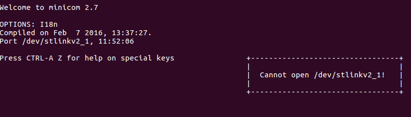

I am trying to run nuttx on STM32F429IDisco device. I am following tutorial from nuttx official channel on youtube. Few days ago i was not able to start minicom. But after some study i was able to start it, using /dev/stlinkv2_2.
https://stackoverflow.com/questions/45627751/minicom-is-not-starting

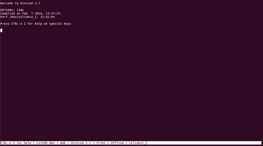

Anyway, at this moment i am stuck at very next step. My minicom have succesfully started but i can't start nsh to run my programs by clicking reset button.
Can anybody tell me what is the wrong i have done ? stlinkv2_2 isn't right way to setup device? or any other mistake?

There is a verified usbnsh configuration in nuttx/configs/stm32f429i-disco/usbnsh.  Are you using that?
Posted on August 16, 2017 at 16:59
No! I am using stm32f429i-disco/nsh
Posted on August 16, 2017 at 18:42
That configuration does not support the USB serial console interface.  If you want the USB console, you need to use the usbnsh configuration.  That is the difference between the two configurations!

I have tried with
stm32f429i-disco/usbnsh but no luck!
still the nsh console is not starting....reset button clicking doesn't start the nsh console.
I have configured Serial Device /dev/stlinkv2_1 ... before that i tried tty0, ttyUSB0, ttyACM0, ttyS0.
I got not found errror for USB0, ACM0. tty0 and ttyS0 shows no error.
When i configured
/dev/stlinkv2_1
at least the device responses. I mean if i unplug the usb at least it shows warning..
What should i do now ?
