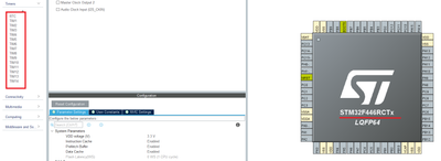

Hello, i am using F446 and i am contemplating using FreeRTOS CMSIS V2 software timer to generate PWM to control motors via motor drivers (IC  chipset). Is this possible? Or must I use the hardware timer, TIM1~7 ?

mƎALLEm
As said by @Andrew Neil ,
There are 14 timers in STM32F446:
You are using half of timers resources in your case only 1 to 7 in your case.. So why bothering yourself with the software timer usage?
