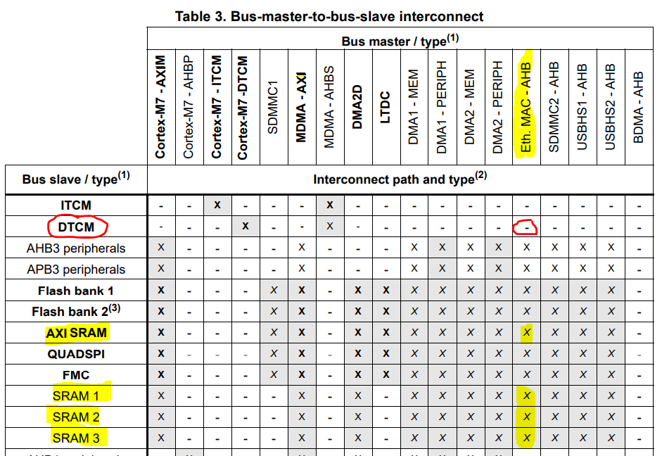

According to the data sheet 4 byte alignment should be OK and that is what I have used.
I tried in D1 and D2 and AXI RAM but didn't notice any difference, although I had DMA errors when trying in DTCM (which is to be expected since the Ethernet DMA has no access to this bus - see below).

There may be opportunities to optimise the memory usage so the use of the other RAM banks will be reviewed as things further develop.
