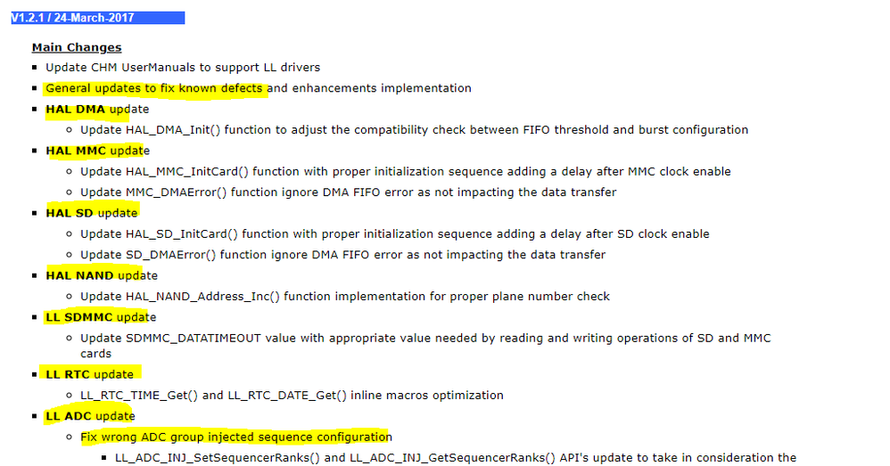

As part of SOUP (Software of Unknown Provenance) validation for a Class C medical device, i need to provide a couple of information.
I am using STM32F7xx series of microcontroller (specifically STM32F765). The version number in use is V1.1.2, i understand the latest version is V1.12.0.
Can i know what are the bugs or issues that are know between the two versions.
This will help me mitigate any particular issues if any in V1.1.2
Any information on this will be valuable.
Thanks in Advance.
Siddiq

While going through the release note associated with STM32F7xx HAL V1.2.6, i can see a comment
"General update to fix known defects and enhancements implementation"
as the start.
These "known defects" are they the bullet points which follow in the same report or would there be other fixes which are not explicitly mentioned.
siddiq.habib
The release note file doesn't provide the exhaustive list of bugs fixed in a given version of STM32Cube package.
-Amel
