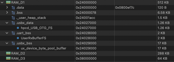

I'm using a NUCLEO-H743ZI2 board and following the examples in Ux_Device_CDC_ACM targeting H723 and Ux_Device_HID_CDC_ACM targeting H747, but no data ever comes in and fails to match the "ux_utility_memory_compare" function in "usbx_cdc_acm_read_thread_entry". I can't seem to find where the interface is, and why the API as is isn't working.

Last bit of info to provide (Since I've been bit by memory configs in the past) is that I use the same MPU config as recommended even though USB DMA is not enabled, there shouldn't be anything special going on here.
.usbx_data 0x24027000 (NOLOAD):
*(.UsbHpcdSection)
} >RAM_D1
.uart_bss 0x24028000 (NOLOAD):
*(.UsbxAppSection)
} >RAM_D1
.usbx_bss 0x24029000 (NOLOAD):
*(.UsbxPoolSection)
} >RAM_D1

‎2022-07-17 11:24 AM
Easy solution. The interface existed in there as I could see it in memory, but missed that you can set to 0 for the interface assignment. This code here works and was in the original example.
/* Registers a slave class to the slave stack. The class is connected with
interface 0 */
if (ux_device_stack_class_register(_ux_system_slave_class_cdc_acm_name,
ux_device_class_cdc_acm_entry, 1, 0, (VOID *)&cdc_acm_parameter) != UX_SUCCESS)
// Instead of
interface 1 */
ux_device_class_cdc_acm_entry, 1, 1, (VOID *)&cdc_acm_parameter) != UX_SUCCESS)
