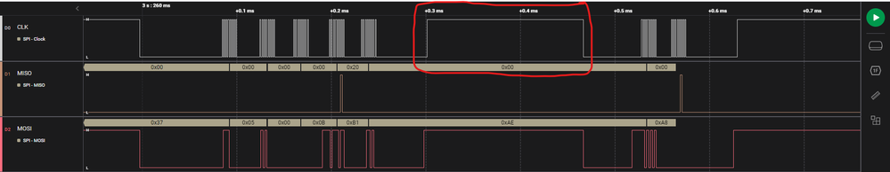

I am using SPI1 on the STM32U575 to transmit data, and my issue is that between consecutive calls to the SPI transmission function, there is an extra long clock pulse instead of no clock pulse at all.

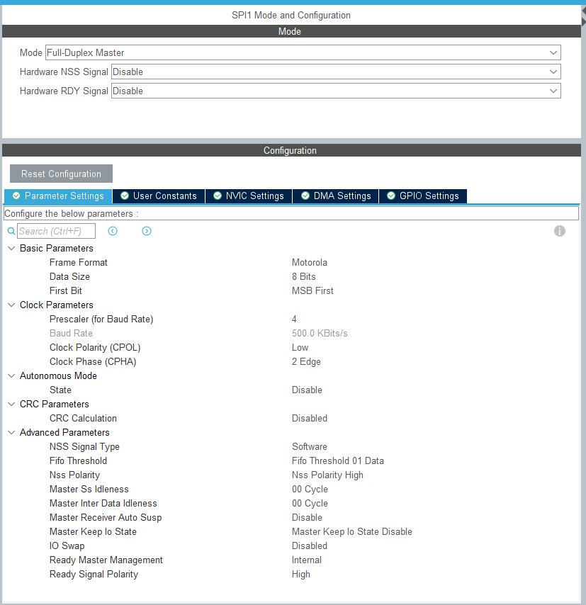

Below is the code and configuration:

try : in Cube -> master keep io state -> enable !

‎2023-09-06 8:30 PM
I have tested my software again with your response, and it is working. Thank you for your feedback.
