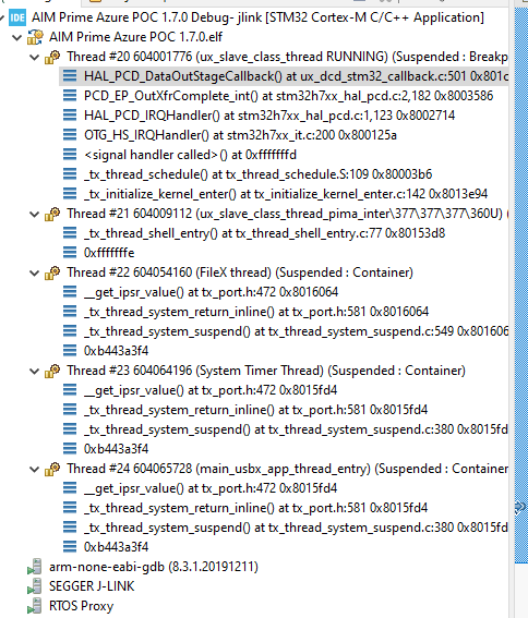

After a breakpoint, I would like to look at my other threads and see where (line of code / function) they are either running or suspended at.
All i see in the call history is __get_ispr_value(), which may be true but is not helpful.
0693W00000GW6bVQAT.pngThanks,

You can display ThreadX Thread list as following:
  • Run application
  • Go to Window --> Show view --> ThreadX --> ThreadX Thread list
