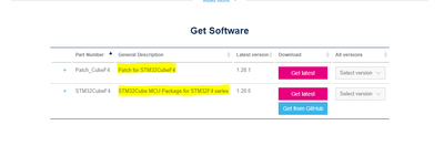

>> That didn't compile due to typedef FLASH_Status missing amongst other things. Looking at some other posts, I learned that it is defined in stm32f4xx_flash.h which isn't included in the download, but I was able to find on GitHub.
The file should be included in the package downloaded from st.com. You need to download the full release package first and then apply the patch release.
For your application you can refer to the EEPROM emulation example available in the STM32F4 firmware.

IIRC, The code in AN3969 predates HAL - it uses the old "Standard Peripheral Library" (aka "SPL", or "StdPeriph").
I suggest:
  1. Get the AN3969 example application working in a project of its own.
  2. Port that example to HAL
  3. Take the ported code, and add it to your HAL project.
