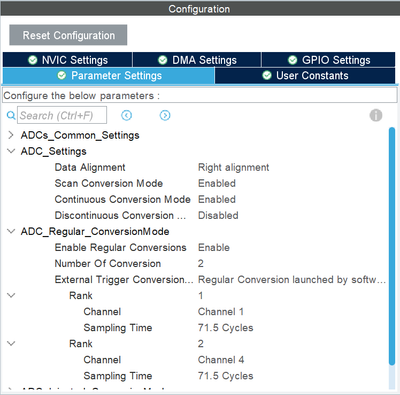

I have 3 potentiometers, one on each channel of the ADC, that vary 3V. The ADC reads the values and converts to voltage.
I have not been able by reading the datasheet and looking at some examples online to figure out how to get it to work using interrupts (with DMA it works).
I attach the entire project, can you kindly check it?
Thanks!

Hi @mƎALLEm ,
I'm using the NUCLEO-F103RB, and the ADC configuration is different. I cannot set the End of Conversion selection to 'Single' when using interrupt mode with multiple-channel scan.
