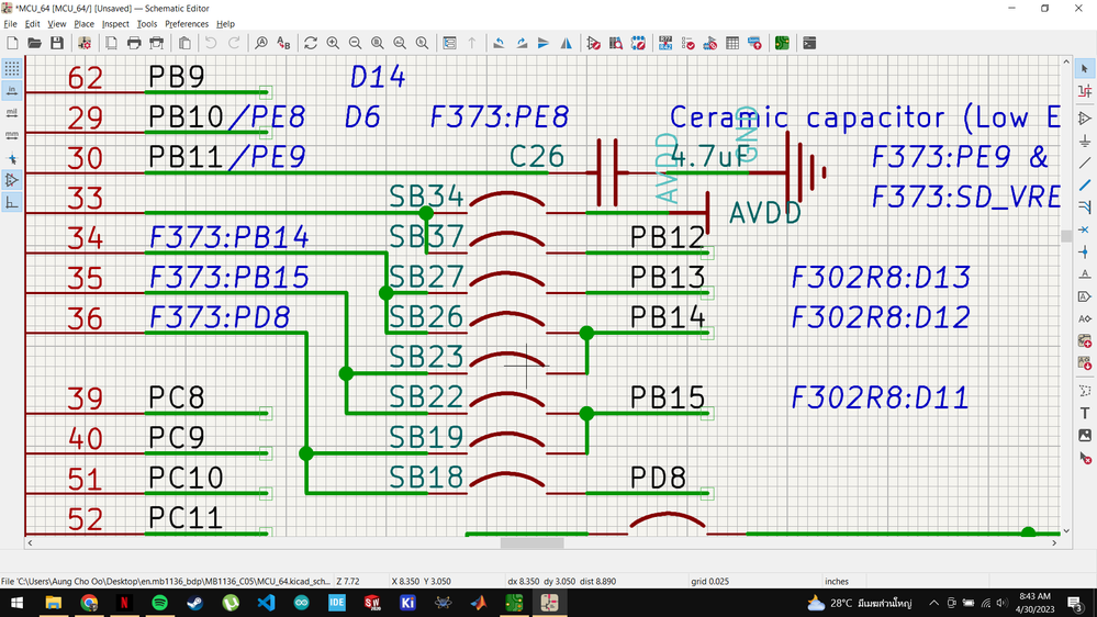

Why use circuit breaker in Stm32 Nucleo Boards?

What are you talking about?
‎2023-04-30 8:38 AM
Sorry for my insufficient information. When I look at that the schematic of Nucleo boards, I found a lot of circuit breaker under SB symbols. Normally I didn't see anything like that in other microcontroller, so I'm wondering what is the purposes of that circuit breaker?
‎2023-04-30 8:43 AM
show pic of this "circuit breaker" . so i dont need to search my big blue glass ball to see it.
‎2023-04-30 8:44 AM - edited ‎2023-11-20 6:47 AM
here it's. the symbol is SB.
‎2023-04-30 8:57 AM
SB stands for Solder Bridge.
In some cases, it provides alternative usages of pins, e.g. whether a Tx pin goes to the on-board STLink's VCP Rx pin, or to an external pin.
Also The board (PCB) itself is rather universal, and ST places several different target STM32s onto it; however, these mcus are not 100% pin compatible and the SBs solve this - for different mcus different set of SBs is closed.
‎2023-04-30 8:59 AM
Thanks you, So it's only to select the pins for different peripherals.
‎2023-04-30 9:07 AM
Yes, like links/jumpers on other boards, but taking less space and parts to implement.
‎2023-04-30 9:08 AM
Thank you guys. I understand now.
