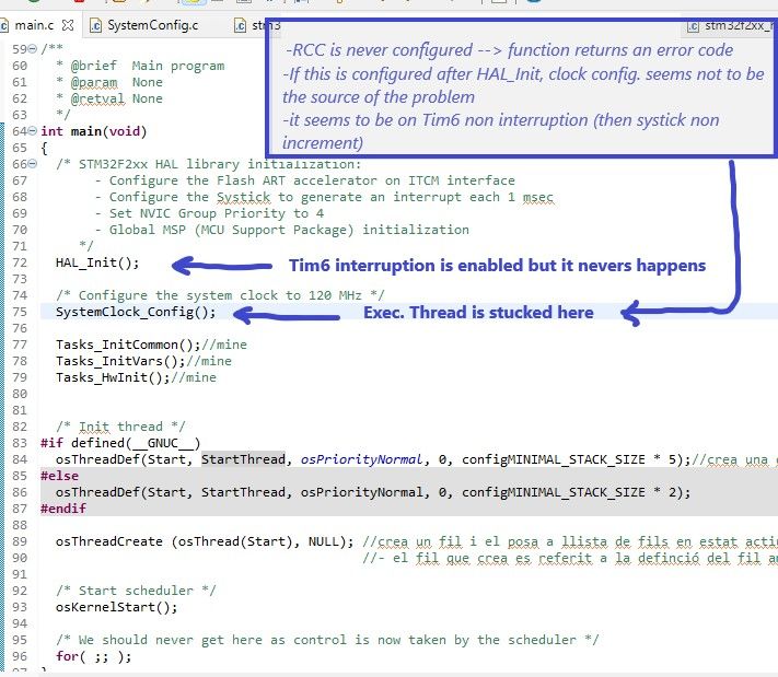

  • Interruptions never happens after HAL_Init()
  • So, thread get stucked at the same point: clock is never get configured, it tourns an error.
  • I'm using HSI clock, so external clock couldn't be guilty.
  • As a reminder I have to say that the same firmware works fine on NUCLEO board.
  • I don't know if the problem is on SEGGER debugger configuration.

Why is the interruption unable to be triggered when:
  1. TIM6 interruption is enabled and
  2. I can see how this is done when I'm debugging on its HAL struct field vaules?
Please if some one could help me with the next steps to find what is the cause I will add the information that could help him to understand my application and its configuration.

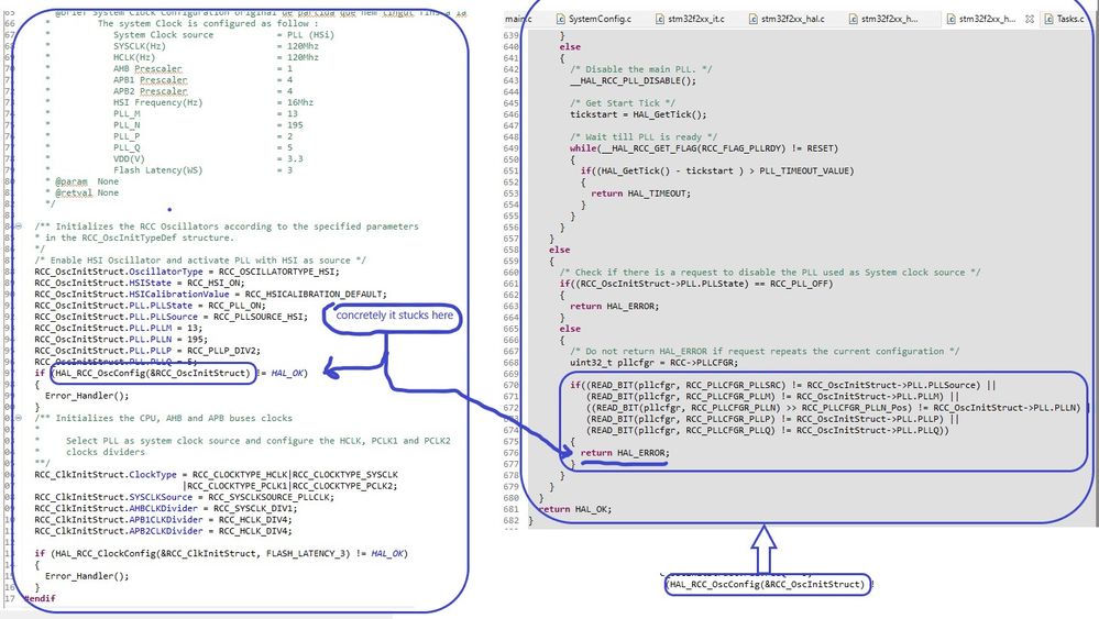

Should be able to run without any debugger attached.
Instrument Hard Fault and Error Handler so you know if things when to die there.
Make sure the IRQ Handler for TIM6 is present.
Unpack NVIC, RCC and TIM6 peripheral register in debugger, or dump to terminal.
Does SysTick or other interrupts work?
Do things work independently, ie you don't call HAL_Init(), but simply bring up the peripheral(s)
Should just continue running at HSI 16 MHz
Does PLL start? What setting for that an VCO?
What specifically hangs up in HAL_Init() ?

Thanks Tesla, I can answer some of your proposed list actions now:

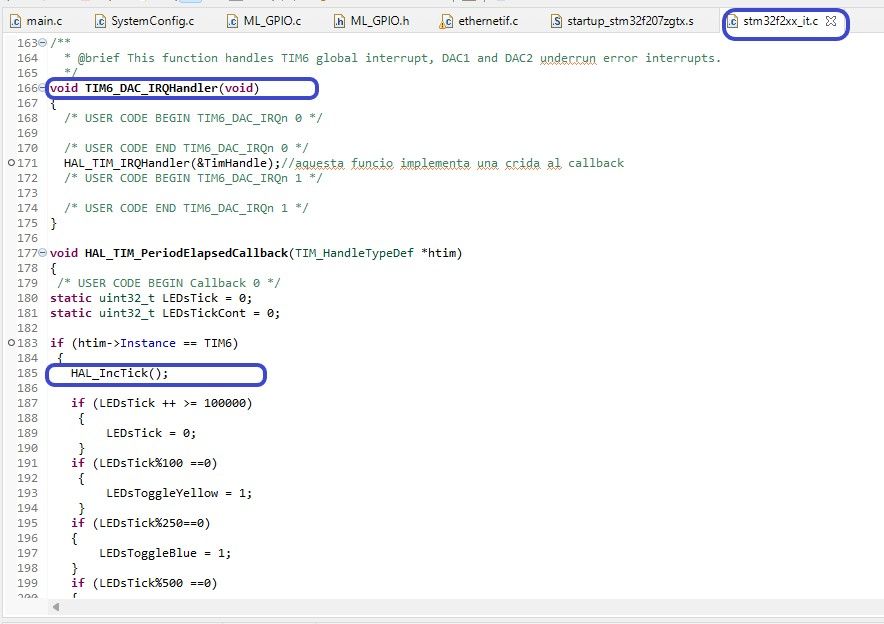

  • IRQ handler is present (image1) but thread doesn't jump anytime there
  • thread execution stucks on RCC configuration (image2) --> it returns error code
  • PLL configuration (image2)
  • HAL_init doesn't hangs up. Function returns an OK error code, but after HAL_init enables TIM_6 interruption, interruption never happens. It happens if the code (with minimal GPIO remapping) runs on the NUCLEO board.
  • Systick_Handler interruption neither other ones don't work.
0693W00000aHQ7uQAG.jpg0693W00000aHPq5QAG.jpgIs any of this comments suggesting something to you?
