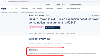

@Jay_Bolboli wrote:
an optical Tx module connected to UART1 Tx, powered by the 5V pin.
Again, look at the schematics to see what powers that 5V pin
EDIT
The X-Nucleo-LPM01A only supplies up to 3.3V - so it's not going to power 5V:
https://www.st.com/en/evaluation-tools/x-nucleo-lpm01a.html

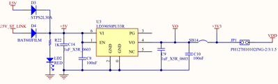

Jay_Bolboli
Dear @RomainR. @Andrew Neil
Thank you for your help and time.
I understand your points. What I gather from what you're saying is that even when JP1 is open, it will not affect other peripherals. However, I believe it does affect them.
In  UM1956 Rev 5, section 6.7, Hardware layout and configuration, it is mentioned that:
JP1 on: STM32 is powered (default)
JP1 off: an ammeter must be connected to measure the STM32 current
If there is no ammeter, STM32 is not powered.
So I think this is because VDD is out . And I think the VDD is the main supply voltage that powers the core and peripherals.
I also connected a logic analyzer to check their signals, and I found that their signals (UART, SPI, and I2C) are available only if JP1 is connected.
FYI:
this is pinout, I took it from CUBEMX that shows how everything is connected. Furthermore, SB14 is closed, while SB16 and SB18 are open for I2C use.
