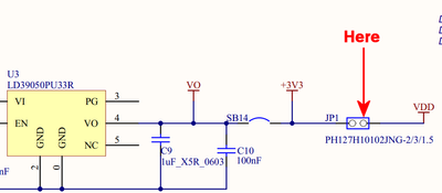

@Jay_Bolboli wrote:
 What I gather from what you're saying is that even when JP1 is open, it will not affect other peripherals. However, I believe it does affect them.
There may be some confusion on what you mean by "peripherals" here?
As you can see from the schematics, VDD is indeed the power supply to the STM32 Target chip;  that will include power to all the STM32's internal peripherals - UART, SPI, I2C, etc.
But power to external peripherals - such as your LoRa and Optical Tx - will depend on how, exactly, you are powering those devices.

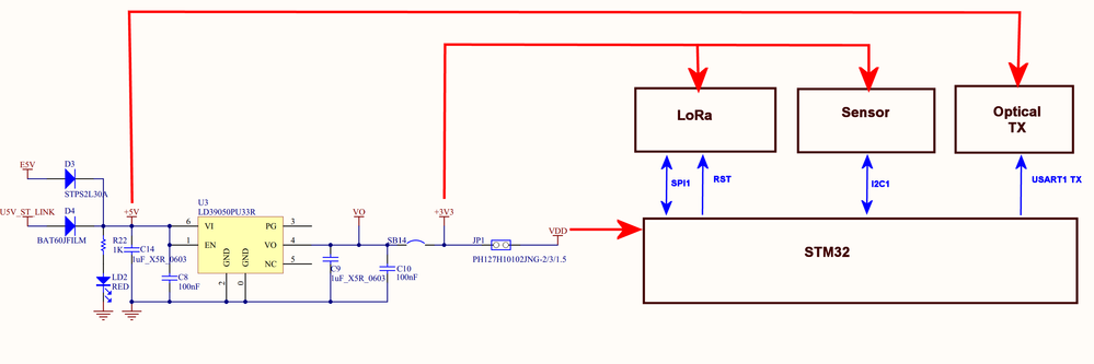

Again, you really need to provide a schematic of your system - showing how you have all these things connected.
Words/text are a particularly poor way to describe electrical connections - especially with language differences. This is why we use schematic diagrams!
Thanks Andrew.
I have provided a photo below that shows all the connections.
Reds are the power lines and blues are the signal lines.
Also, I have to mention that I tested the system. when JP1 was not connected signal lines did not work (I checked with a logic analyzer) but power was available. And when JP1 was connected everything worked fine.

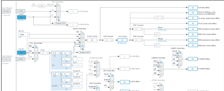

Clock Configuration (I used MSI):

So your power supply scheme looks like this:
  • Your LoRa, Sensor, and Optical TX are always & only supplied from the Nucleo
  • Your STM32 is supplied from the board when JP1 is fitted, but is must be separately supplied when JP1 is removed (or an ammeter needs to be inserted).
What do you mean by "power was available" there?
As you can see from the above diagram, power comes from three different places - they need to be all available for the system to work.
Jay_Bolboli
Yes, your diagram is correct.
  • LoRa, Sensor, and Optical TX are connected to +3v3 and +5V pins
  • STM32 also is supplied from X-Nucleo-LPM01A using AREF pin
All three power sources are available for the system (I have checked the pins using a multimeter).
however, I am not sure if the AREF pin is internally connected to smt32 or not. Based on the diagram it is connected and there is no bridge and it is connected to AVDD directly.
Why not apply it at the VDD side of JP1 ?
Note that you'd also need to link the X-Nucleo GND to the L432KC GND

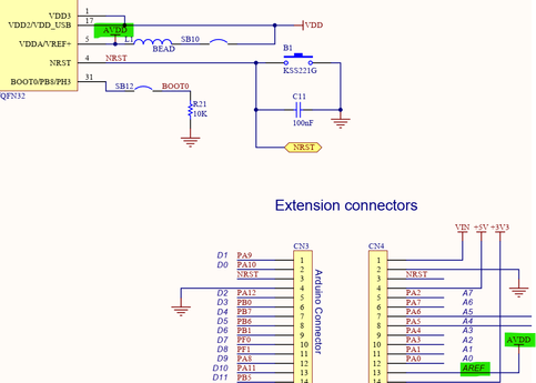

Yes, it is connected via SB10 and the L1 ferrite bead - which is there to filter digital noise from the analogue supply.
You are effectively feeding the power from the "wrong" side of the filter.
Jay_Bolboli
Hello @Andrew Neil @RomainR.
I want to thank you both for your help and support.
It appeared that the problem was the AREF. It was provided by the X-Nucleo-LPM01A, and I was able to measure it on the pin.
However, I discovered that internally, the AREF wasn't connected to MCU. I suspect this might be due to the ADC. In my application, I'm using the ADC, so it's likely that the AREF was being utilized as the reference voltage for the ADC. When I tested it without the ADC, the problem was solved.
