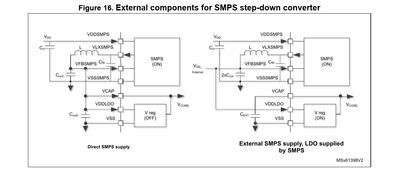

No - its just: you can do different setups, depends on...what you want: best efficiency or highest clock.
Because the smps -> core has some ripple, it cannot supply the core at "its limits", so not at max. clock.
Here you need the smps -> LDO -> core , so smps is main buck , but LDO makes clean supply for the core.
from ds:
On your disco board its wired for max. eff. , so ldo unused. Do not try to set anything else in Cube ! (at this state of disco board ).

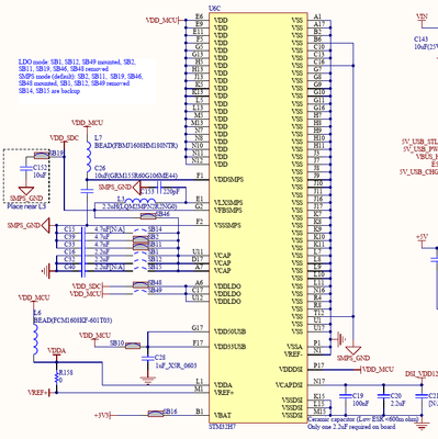

IF you want check it at max. speed, change the solder bridges on the disco board to smps->ldo -> core.
(in blue text in pic ...but check, if all seems ok.)
And make a new project in Cube, not starting with H747-disco (board), but just (as in your future product) H747XI (cpu) project. Here you can set the smps->ldo mode and run the chip at 480M.

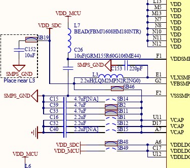

OK, so what I understand is that I can use the internal SMPS to power the LDO so that I get smooth (low ripple) power to the core (smps -> ldo -> core) and then can run the core at 480 MHz. I just need to make the jumper (solder bridge) changes on the discovery board to route the SMPS to the LDO and disconnect from VCAP pins.
Looking at the datasheet figure 16 and the disco schematic:
  1. Remove SB46 so the SMPS does not feed VCAP
  2. Remove SB2 and SB11 - disconnect the 4.7uf caps
  3. Add SB1 and SB12 - connect the 2.2uf caps
It looks like those are the only solder bridges to change to connect output of SMPS to input of LDO. Any other solder bridge changes would disconnect the SMPS (rendering it useless) and only power the LDO from the main VDD into the board. Disconnecting SB19 would remove the SMPS output cap unstabilizing the SMPS and disconnecting SB48 would completely disconnect the SMPS from the LDO. Does that all sound correct?

You have to separate the vcap from smps !  -> remove sb46 !! add c152 + sb19 (if not there)- check.
But double check: not to supply/connect core (VCAP pins) with SMPS any more ! You kill the cpu then.
check this and the connections you made with DMM for good contact - before apply any power !
Otherwise - not so difficult action - right ?
Tank you everyone for your help.
I was able to get it working with the SMPS powering the LDO and running the system clock at 480 MHz.
AScha.3, I am accepting you last reply as the solution. I only had to remove the SB46 as C52 and SB19 were already on the board.
