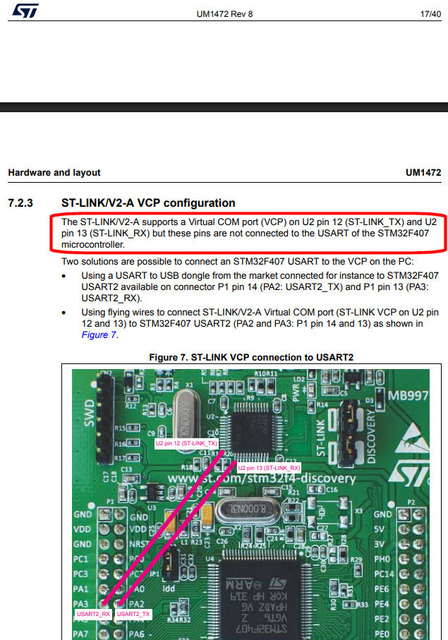

If I remember correctly, the ST-Link embedded in the F407 discovery is not wired to a target MCU UART, and thus has no VCOM capability.
You could connect a USB-to-Serial adapter to you target USART pins (PA2, PA3), provided the adapter works with 3.3V, not 5V.
Following the link to the tutorial, it does not mention the F407 discovery, for that very reason.

@Ozone wrote:
If I remember correctly, the ST-Link embedded in the F407 discovery is not wired to a target MCU UART...
This is true.
@Ozone wrote:
... and thus has no VCOM capability.
This is not true.
The Virtual COM Port (VCP) capability is there - it's just the physical connection that's missing.
@cockatoo  This is described in the User Manual:
https://www.st.com/resource/en/user_manual/um1472-discovery-kit-with-stm32f407vg-mcu-stmicroelectronics.pdf#page=18
via: https://www.st.com/en/evaluation-tools/stm32f4discovery.html#documentation

@cockatoo wrote:
What should I use if I need data transfer between PC and F407 discovery if there is no UART?
There is a UART (in fact, the STM32F407VG has four UARTs) - what's missing is just the physical connection from the UART to the PC.
As described, you need to provide that physical connection.
You have two options:
  1. Add physical link wires to the Discovery board;
  2. Connect to a separate USB-to-UART adaptor.
(I guess a third option would be to choose a board which does have this connection built-in - most do nowadays)

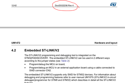

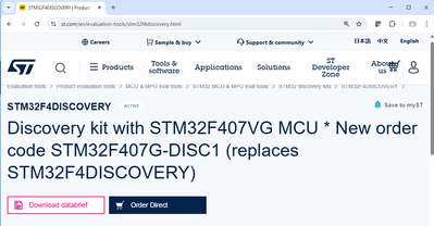

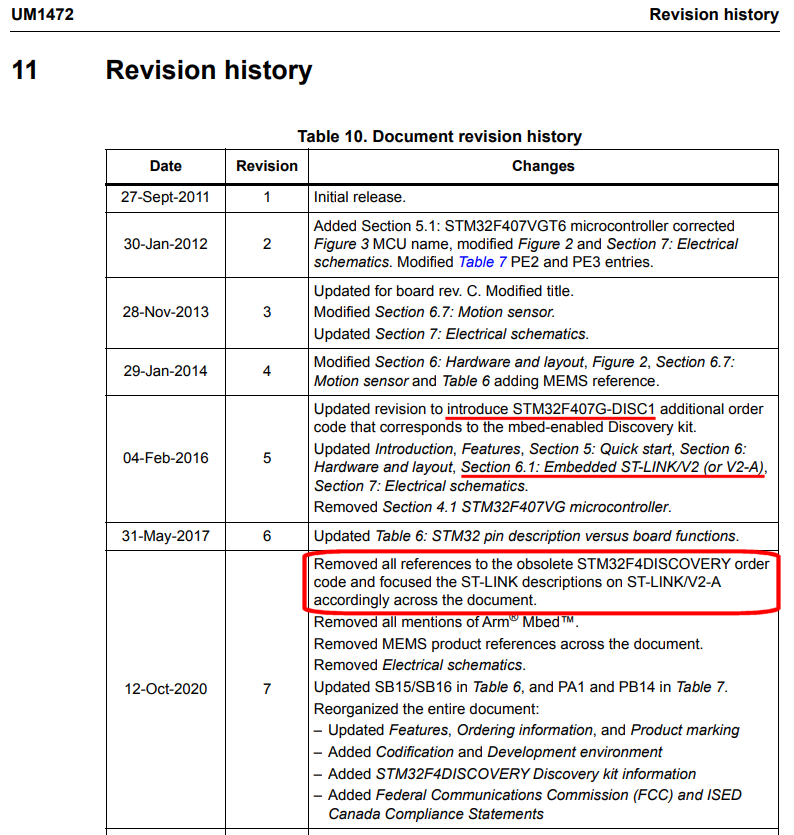

All of my F407 Disco boards are the older version with ST-Link V2, which has no VCOM capability at all :
Just fore reference.
Later boards, like all of the Nucleos, have one target MCU wired to the onboard ST-Link (V2.1 or later), install the VCP driver automatically, and work "out of the box".
This boards not.
This is probably why the tutorial site did not mention them.
Maybe that's the difference between the OP's DISC1 and the original DISCOVERY?
PS:
Indeed, it seems so:
So they updated the ST-Link to add VCP Capability, but didn't update the board to take advantage of it!

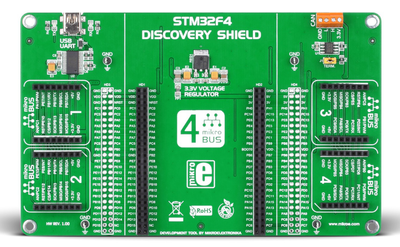

This Mikroe shield board has been great to use and has a built in USB connector to USART2 and a connector to CAN1
https://www.mikroe.com/stm32f4-discovery-click-shield
