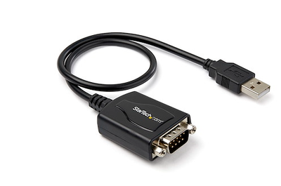

Then I connected it to a PC com port (USART1 via CN2). To do that I used a USB to COM convertor from StarTech.

If your USB to COM convertor from StarTech is RS-232, you cannot connect that directly to USART pins...

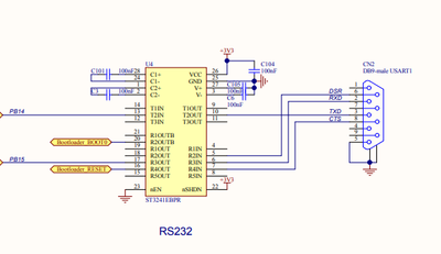

something like this :
ed: this is wrong. The CN2 is real RS232 connector, so i was wrong.
IF yes - you killed the cpu's.
Because this is real RS232 with RS232 level output (+/- 8 V or so) , but cpu is 3v3 system and needs a RS232 signal - but at 3v3 voltage level !

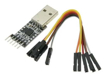

So replace the damaged cpu's , or buy new board. Then use for USB - Serial converter something like this :
USB -> serial (3.3 V level)
No. The H7 Eval boards have a normal DB9 RS232 connector.
@Pavel A.  , your right. I just was thinking, he connect to a cpu uart ...
but CN2 is :
But then : what he did wrong ?
CN2 is a DB9 RS232 port on EVAL board, top center-left
https://www.st.com/en/evaluation-tools/stm32h757i-eval.html
I don't see this electrically damaging the board unless something is very wrong with the PSU and grounding situation.
The claim here is the STM32H757 is damaged.
The STM32H7's can be come difficult to communicate with and debug if the LDO/SMPS configurations don't match the hardware.
There's a power-cycling, BOOT0=HIGH method to recover those.
As Pavel points out the board really needs to run from the DC supply, the one provided in the box..
More probably a power / regulator issue than one of RS232 per se..

A also measured my USB to COM and got +/-9 V.
