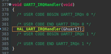

AScha.3
basically it should work, but :
- did you enable callback in Cube ?
- on any error uart will stop working - and then..?
You need callback on receive + error :
void HAL_UART_ErrorCallback(UART_HandleTypeDef *huart)
	printf("UART7 error testvar hex %ld \n ",testvari);
	// *** ... try again
	HAL_UART_Receive_IT(&huart7, &ESP_RX[ESP_RX_COUNT], 1);

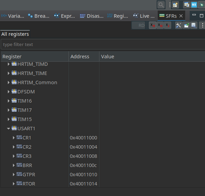

tibaalAuthor
thank you but this solution doesn't seems to work. I modified my program since last time, here it is.
the principal evolution is that I use UART1 for the GPS and UART2 for the Lora module. (I have also I2C for a C02 sensor but I don't use it for the moment).
I enabled callback and put this error function. I don't have any results, I don't recieve any message that indicates that i went in my interrupt.

AScha.3
It should work now.
Did you check, the interrupt is called at all?
Maybe you puzzled a wire... so make a breakpoint in the UART int, just to see, the UART getting data at all.
If nothing, look in debug at the SFR, UART registers and the settings there.
And what is in Rx data register...at all.
