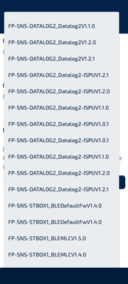

I'm also not sure which FW should be loaded on the STWIN.box, the Android app shows a long list, and I haven't found any information about the different FWs.

Hello @Ferag
STWIN.box default fw is not DATALOG2. You must update the board with the desired firmware.
STWIN.box is supported by different Function Packs from ST. That's the reason for the very long list in the app, where for each firmware all the versions released are available.
If you are interested in DATALOG2 you can update the board through a FOTA using the ST BLESensor app. The last version we released a couple of weeks ago is the v1.2.1, so you can select FP-SNS-DATALOG2_Datalog2 v1.2.1 from the list.
Have a look also to the board User Manual (link) for all the details regarding the Default FW and the firmware update.
