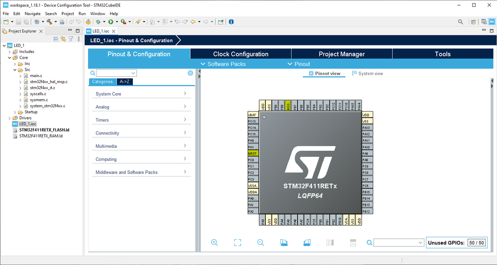

Installed STM32Cubde IDE on my machine and selected my board.
I was expecting some of the pins/peripherals are set by default but as shown in the screenshot they are not.
How to fix this issue please?

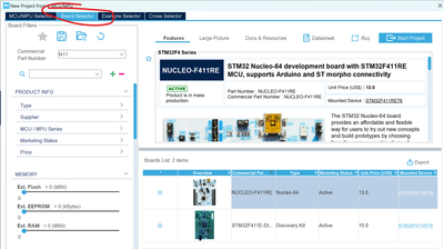

Use the Board Selector, not the MCU Selector.
You can use either one, but if you want peripherals auto-initialized, you have to use the board selector and select the board you have.

Hello @TechyAry and welcome to the ST Community.
I think you didn't click on the "Yes" button on the Initialize all peripherals with their default Mode message after clicking on the finish button.

Hello @STTwo-32  and thanks.
I guess I clicked on that button but since it's my first working project I may have got wrong.
Is there any solution to fix that issue now or should I delete that project and create a new stm32 project from scratch please?

Deleted the project and also checked "delete project contents on the disk", then created a new stm32 project named LED_2. Now the peripherals are properly initialized by default.
