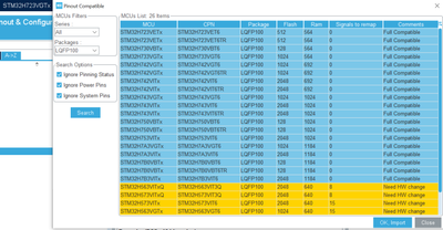

Is the STM32L4P5G-DK Discovery Kit also compatible with other STM32L4P5xx components, not just the STM32L4P5AG?

The STM32L4P5G-DK is a discovery Board based on the STM32L4P5AGI6P. If you are looking for MCUs pin to pin compatible with the STM32L4P5AGI6P. You can use the pinout compatible option on the STM32CUBEMX:(the picture is not for the L4 bit just an example)
Does this answer your questions.

Hey STTwo-32,
That's perfect, thanks for the help!
