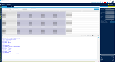

Today once I connected the board to my PC; I noticed that nothing pops up in the display;; I mean... black screen.
But ... I can see the green lights over the board on and I'm able to connect it thru the SMT32CubeProgrammer
here is an Image:
is connected.
What can I do to see graphics over the display?

Your screenshot shows that the FLASH is erased (0xFF). That means there is no program on the board, so nothing is sending data to the display.
Is this a STM32H7B3I-DK? You can re-flash the demonstration firmware if you can find it. I can try to look...

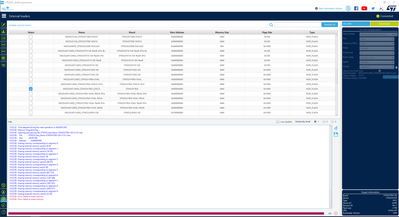

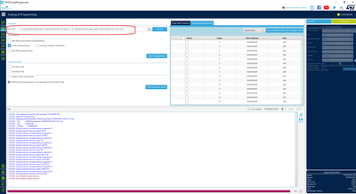

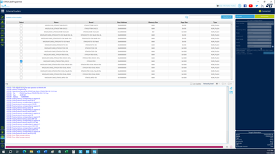

I did the step; the re-flash, but looks like there is a problem once STM32CubeProgrammer try to delete the external memory
in the next image; you can see that... I'm trying to upload the demo.hex
and I have as External loader the one which is in the next image:
In resume: the problem is when then CubeProgrammer is trying to delete External Memory
