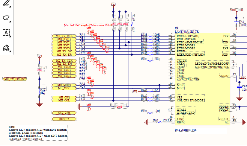

I've been working on getting Ethernet working on the STM32H750B-DK discovery board with TouchGFX and LwIP. After extensive debugging, I suspect a hardware issue and would appreciate your advice on confirming this.
What Works ✓
  • TouchGFX display runs perfectly
  • USART3 debug output works (Tera Term shows messages)
  • PHY communication works (we get "Link established!")
The Problem ✗
The Ethernet MAC peripheral itself appears completely dead. We've tried:

Given that the working example uses MII mode and my board is the same model, my board almost certainly uses MII mode with the PHY as clock master  (example in https://github.com/stm32-hotspot/STM32H7-LwIP-Examples/tree/main/STM32H750_Disco_ETH). This means:
My 48MHz MCO experiment was misguided (wrong frequency, wrong mode)
PA1 should be receiving 25MHz from PHY, not generating 50MHz
The DMACSR=0 issue is likely due to the descriptor address mismatch we already identified, not the clock
First, I'll fix the descriptor addresses as follows:
Setting Current Should Be
ETH ModeRMIIMII
Rx Desc Address0x300001000x30040000
Tx Desc Address0x300001000x30040060
Rx Buffers Address0x300002000x30040200
MCO1/PA8ConfiguredRemove MCO1 config
Linker ScriptHas .lwip_secGood as is
this is the most likely cause of DMACSR=0
Revert MCO1 configuration -
set PA8 back to default/TIM function
Test again
LCE
Principal II
If the PHY is the LAN8742A as on most ST boards, it's surely an RMII interface.
Looking at the board schematics, it indicates MII mode:
MII Signal STM32 Pin Status
ETH_TX_CLKPC3✓ Configured
ETH_TX_ENPG11✓ Configured
ETH_TXD0PG13✓ Configured
ETH_TXD1PG12✓ Configured
ETH_TXD2PC2✓ Configured
ETH_TXD3PE2✓ Configured
ETH_RX_CLKPA1✓ Configured
ETH_RX_DVPA7✓ Configured
ETH_RXD0PC4✓ Configured
ETH_RXD1PC5✓ Configured
ETH_RXD2PB0✓ Configured
ETH_RXD3PB1✓ Configured
ETH_CRSPA0✓ Configured
ETH_COLPA3✓ Configured
ETH_MDCPC1✓ Configured
ETH_MDIOPA2✓ Configured
ETH_RX_ERPI10✓ Configured

> I am trying to communicate with UART3 to Tera Team, will you help verify please:
It looks OK. USART3, should be on pins PB10, PB11. Anything does not work?
AT LAST PINGING:                                                                                                                                                          Request timed out.
Request timed out.
Reply from 192.168.1.10: bytes=32 time<1ms TTL=255
Ping statistics for 192.168.1.10:
Packets: Sent = 52, Received = 9, Lost = 43 (82% loss),
Approximate round trip times in milli-seconds:
Minimum = 0ms, Maximum = 0ms, Average = 0ms
Control-C
^C
C:\Windows\System32>
