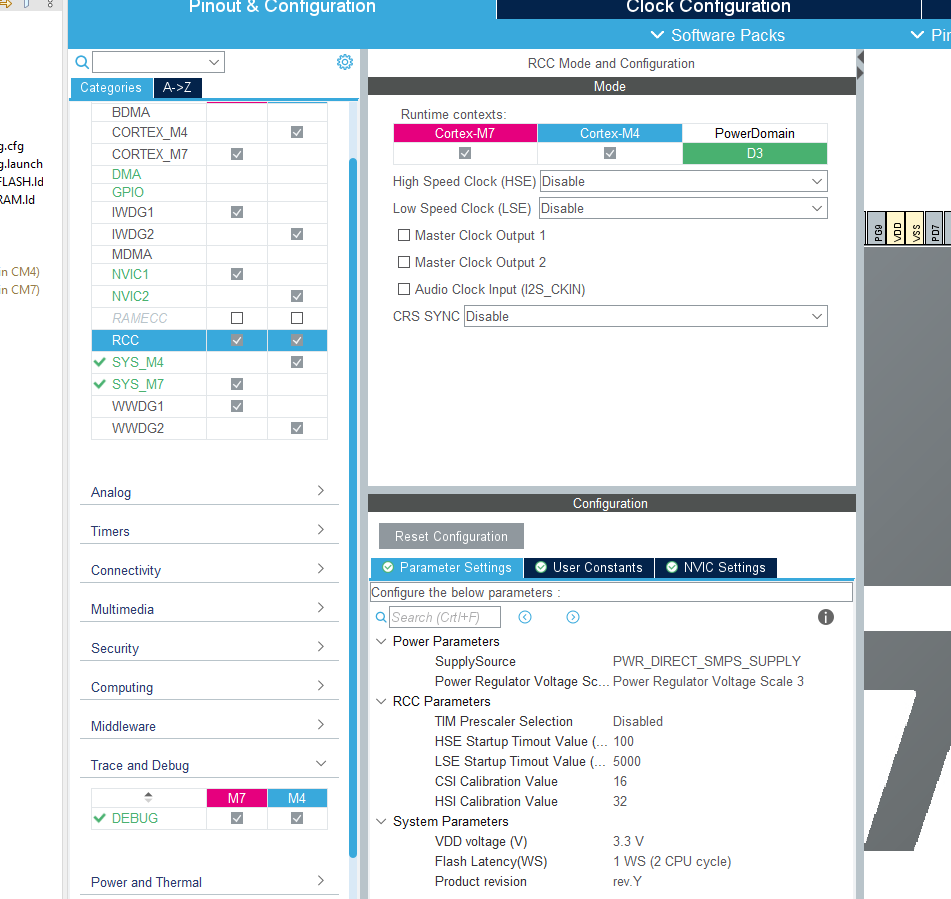

hii am using a STM32H745BIT6 chip it is connecting to the st-link but when i try to debug it its not letting me do itit says the following error:

i did try to erase all the memory but it says its read protected and i checked in the options bites too there is no protection
10 REPLIES 10
fMoha.1
can any one tell me where should i define i am using an internal clock
