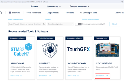

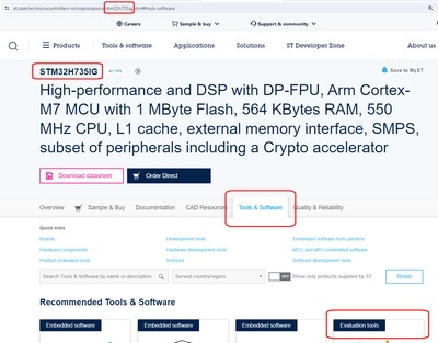

As always, go to the Product Page for that chip, on the 'Tools & Software' tab look for 'Evaluation Tools':
https://www.st.com/en/microcontrollers-microprocessors/stm32h735ig.html#tools-software
Follow the link:
As @STTwo-32 said, the only option is the STM32H735G-DK:
https://www.st.com/en/evaluation-tools/stm32h735g-dk.html

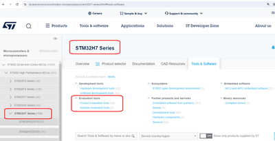

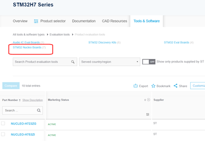

Can You recommend any NUCLEO board for stm32h7 series ?
Again, go to the STM32H7 page, and look on the 'Tools & Software' tab:
https://www.st.com/en/microcontrollers-microprocessors/stm32h7-series.html#tools-software
That 'Product evaluation tools' link takes you to:
