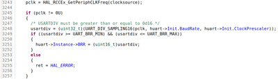

‎2024-03-28 1:28 AM - edited ‎2024-03-28 1:28 AM
Thank you for your ideas.
The UART fails to initialize because of an error in the function UART_SetConfig(). I added a screenshot with the part of the function that fails. The variable pclk contains the value 7 which results in usartdiv=0. When I run the same function with the debugger, the variable is 250.000.000 (which makes sense as I run the MCU with 250 MHz). It has to be a problem with the clock configuration but I don´t get what it is.
