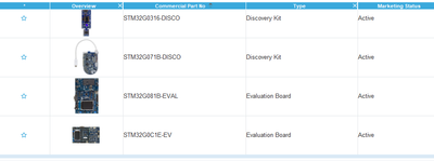

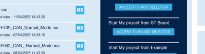

You can use STM32CubeMx and select Access to the board:

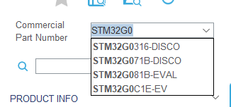

And type "STM32G0":
These are the available boards for G0 product:

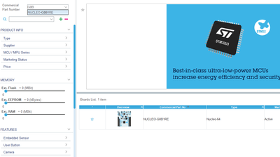

So No EVAL board available for this exact part number but only Nucleo board:
 STM32G0B1CE is a 48pin package while the Nucleo board is a 64 pin package. You can use it and adapt it later to your application. Both part numbers yours and on the on eon the Nucleo board have 512kB of flash.
