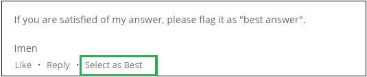

Hi @MJean.3​ ,
Glad to know you have found what you need :)
You will find the "Select as Best" flag below in my previous answer.
Imen

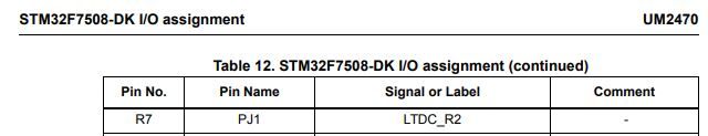

I tried to find the declaration of 'gpio_pin_1' with no success (I found it in an example).
Jean
Hi @MJean.3​ ,
The specific assignments for each pin are detailed in the device datasheet: STM32F750x8 Datasheet , in the Table 10. STM32F750x8 pin and ball definition.
The user button (B_USER) is connected to the PI11.
0693W000005C5AAQA0.jpg>> I tried to find the declaration of 'gpio_pin_1' with no success (I found it in an example).
Do you mean PJ1 pin ?
