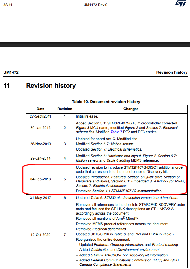

I bought STM32F4DISCOVERY. But in the STMcube IDE, i see only STM32F407G-DISC1 board.
  • Are STM32F4DISCOVERY vs STM32F407G-DISC1 same?
  • Can I select STM32F407G-DISC1 and create a project in the IDE and use STM32F4DISCOVERY hardware to run the project? Will it create any issues?

Yes, they are one and the same.

Hello @dheerajpk and welcome to the community;
The new order code STM32F407G-DISC1 replaces STM32F4DISCOVERY.
The STM32F407G-DISC1 with ST-LINK/V2-A replaces the obsolete STM32F4DISCOVERY order code with ST-LINK/V2.
For more information; I Recommend you to look at Discovery kit with STM32F407VG MCU - User manual section 8.2 STM32F4DISCOVERY product history.
Thank you.
Kaouthar
Are they?
Didn't the original one not have the VCP in the ST-Link?
