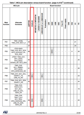

1. I configured the I2C1 (PB6 & PB9) to interface with the CS43L22 Audio DAC on the Discovery Board and it gets stuck at waiting for the SB bit in I2C1->SR1 register to be set.
2. Then, I configured PB6 as I2C1_SCL and PB9 as I2C1_SDA to interface with an external EEPROM, the 24C256N to write data to the memory. It also gets stuck at waiting for the SB bit in I2C1->SR1 register to be set.
3. Then, I changed the I2C1_SCL to PB8 and kept I2C1_SDA as PB9, and I can successfully write and read the EEPROM.
The problem I am facing is, the I2C_SCL for the CS43L22 is mapped to the PB6 of the STM32F411VET6 MCU and it is not possible to have a workaround this.
That shouldn't be a problem - that is the documented design:
If the I2C connection to the audio DAC (CS43L22) isn't working, then you need  to debug what's wrong.
Does it work with the standard ST examples for the board?
Note that the LSM303... e-compass is also on I2C1 - does  that work?

Without having a look at the schematics or the CS43L22 datasheet, isn't there some reset signal which has to be pulled to appropriate level before the DAC starts to be responsive? And same for the MEMS chip to which the same SCL/SDA is connected, too.
