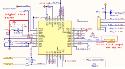

Incidentally, this could also be a source of error: if you have not removed SB16 or SB50 while trying to use your own crystal at X3, the crystal will be disturbed by the MCO of the ST-LINK/V2-1.

‎2024-10-17 4:54 AM - edited ‎2024-10-17 4:57 AM
Meanwhile, you can use STLINK-MCO as clock source for the MCU instead of installing an external crystal.
The source of STLINK-MCO is generated from a 8MHz Crystal.
So, you need just to check that SB16 and SB50 are soldered. You need also to remove the crystal and the capacitors you've already soldered and configure HSE in Bypass mode.

I don't see an issue in the ioc file.
But did you check the recommendations shared by @Peter BENSCH , you need to disconnect STLINK-MCO from OSC_IN OSC_OUT pins of the MCU or just use STLINK-MCO as it is as I described in a previous comment.
‎2024-10-17 6:12 AM
I am trying his recommendation, can you please guide me on how to disconnect the STLINK-MCO from the MCU.
‎2024-10-17 6:27 AM
That's described in the board's User Manual.
See also the board schematics.
