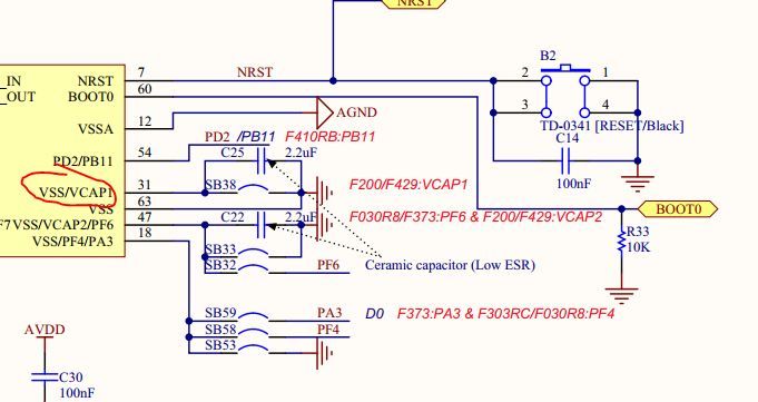

Ssona.1
Is there any VCAP required for this IC ?
Please provide your comment.
