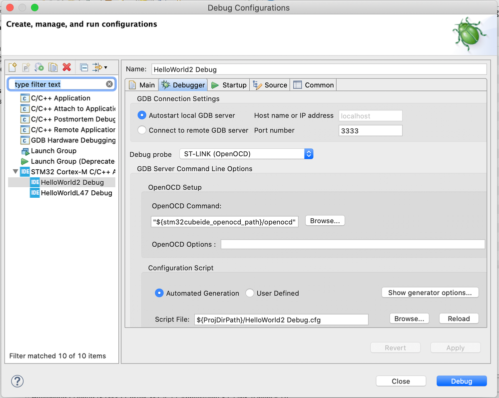

Found a fix! I am also running the STM32CubeIDE on mac and running into this issue. I remember I had to do some funky thing when installing STM32CubeIDE on OSX Catalina, not sure if that had something to do with the programming not working. From googling around it seems like other users only encounter this problem with Catalina, not previous releases. I really can't believe that ST does no continual testing on their products when new OS's are released. Or if they do, that they are slower than the community fixes here...
The fix is to set the programmer to ST-LINK (OpenOCD) instead of ST-LINK (ST-LINK GDB Server), see screenshot below. The OpenOCD debugger seems to be able to auto-negotiate a speed that works with the debugger.

This is actually a very common problem with MANY STM32 dev kits. It's not even a Mac issue, it's an issue with ST loading STUPID demo firmware onto the boards, which disables the ALT state of the SWD pins as it runs. The STLink FW is apparently too slow to catch the chip during startup, before it applies these bad settings.
Anyway, use STLINK (OPENOCD) mode the first time you load your code. Set this in the "debug configurations". Get rid of ST's garbage demo firmware. Then you can go back to the much better STLINK (STLINK GDB SERVER) mode, for the second time.
