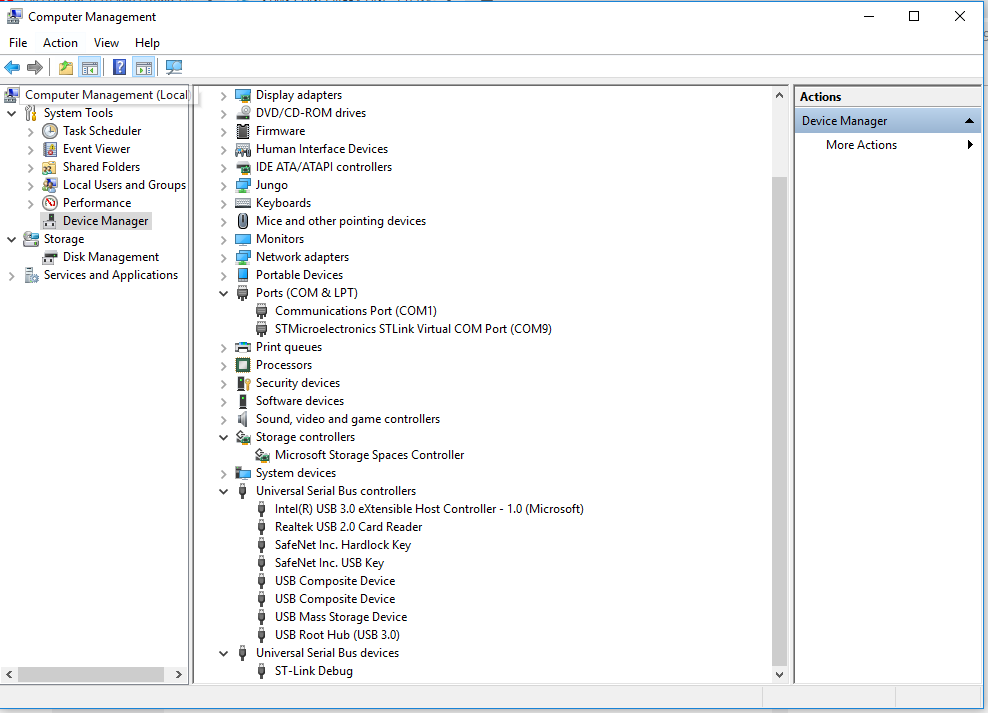

Make sure you have current firmware on the ST-LINK, and that you don't have any AV software or performance/diagnostic software writing to the mbed mass-storage drive.
Yes. I'm using DELL machine at my company to program my board. But I also use my HP laptop to program and get same problem.
Firmware of ST-LINK is OK. And because STM32F407VGT6 chip on my board was not working, I replaced by STM32F407VET6. So I didn't know that job was a cause of my problem
It is not my experience that parts magically erase.
Just saying a write to the mbed MSC might precipitate an erase. Current ST-LINK firmware is V2J32
yes. current ST-LINK firmware is V2J32M. And when I connect my board, driver connect such as image below. I don't know there is any software writing to Mbed MSC as you say0690X000006CyIhQAK.png
