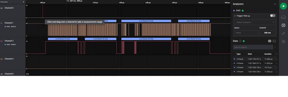

Hi there.ive recently made my own circuit board which and I having trouble getting the stlink v3 to detect my f411 mcu. I've checked my oscilloscope and I can see the swd, swclk , and reset lines being driven by the programmer but I'm unable to get the cubeide to detect my mcu. The power rail is also clean too.
Is there a compatibility chart for the stlink v3 somewhere please? I'm using the mini version.

Yes, ST-LINK/V3 will work with any of the STM32, you might have to drop the connection rate as the V3 can clock faster than CM0(+)
For F411, make sure VCAP capacitors and voltages are correct. The VDDA is powered, as this deals with the POR and PLL too, not just ADC/DAC
Check state of NRST
Check part orientation
Test with STM32 Cube Programmer, first

Cheers for the confirmation! I'll have a look. I have taken a capture of the SWD lines here. 0693W00000KbaHWQAZ.bmp

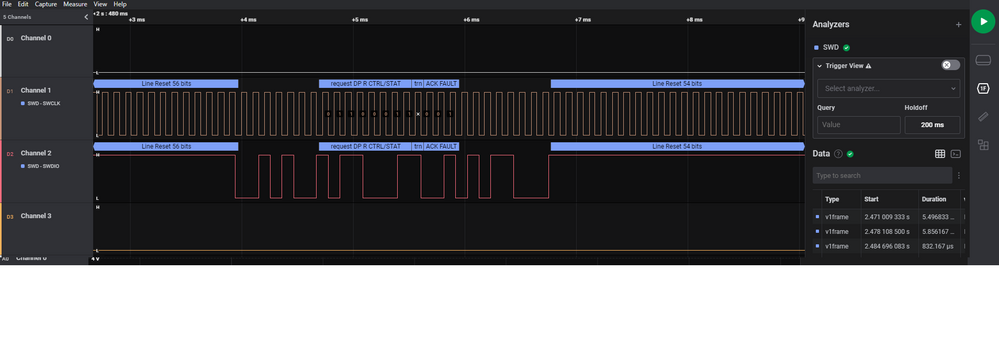

0693W00000KbaI5QAJ.bmpI've lowered the speeds. For some reason, there's an ACK failure after the turnaround. I'll have a look at your suggestions. Thanks

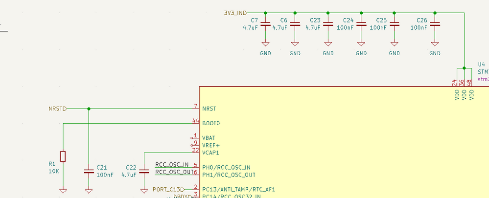

All of the required caps and voltages are connect too
SBrid
Is it required that I connect VBAT to VDD?
What voltage do you measure at VCAP1 ?
VREF+ should be connected to VDDA
Data Sheet:
 If VREF+ pin is present, it must respect the following condition: VDDA-VREF+ < 1.2 V
SBrid
Thank you! The problem was with the vref pin not being connected!!!​

Could somebody please explain why vref needs connecting (or needs respecting VDDA-VREF+ < 1.2 V) in order for my MCU to work? From what I can gather, vref is only for the ADC component.
