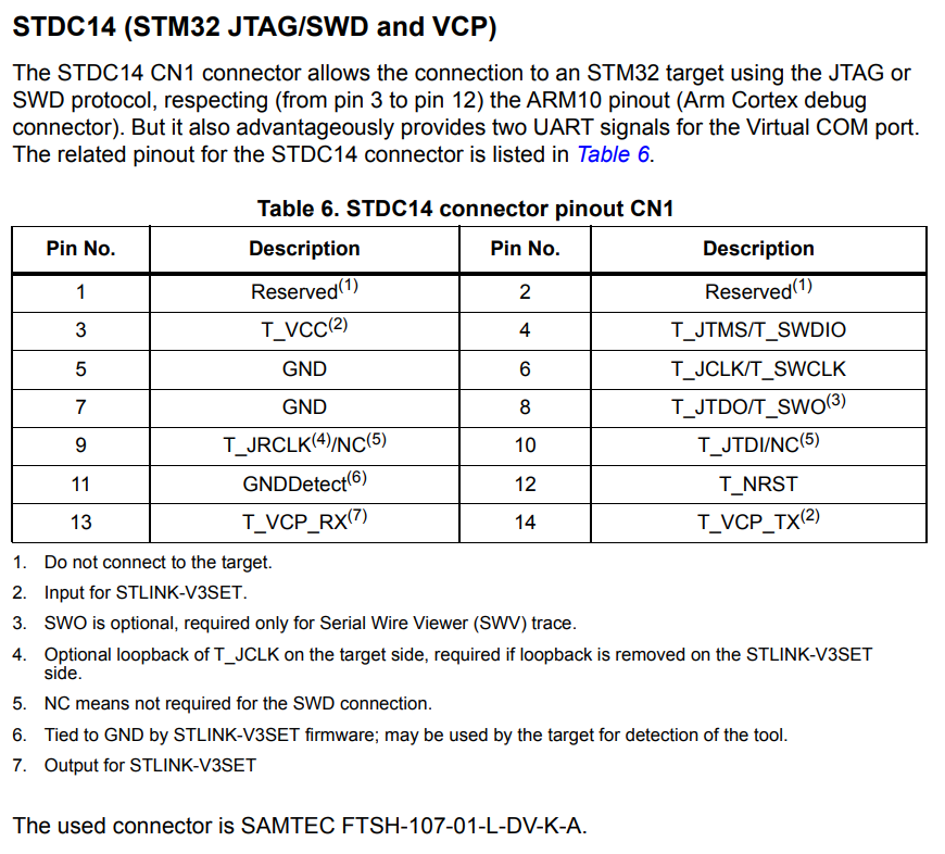

Hi, I'm making a board on which I want to use the STDC14 connector of the STlink V3 programmer for the SWO interface of my MCU.
But I have some questions about the pinout, in the manual I find this table:
0693W00000Y7gU8QAJ.png1 - PIN 3 (T_VCC): this pin must be connected to the power supply of my board or is it a power supply that comes from stlinkv3? My board is powered externally, should I connect this pin to my board's VCC or should I leave it unconnected?
2 - PIN 11 (GNDDetect): I don't understand what this pin is for, should I connect it to the ground of my board or should I leave it unconnected?
Last question, where can I find a reference schematic for SWO interface with ESD protections and short circuit protections and all necessary protections?
Thanks in advance.

  1. see " (2) " : connect, is input to sensing/test VCC on target; connect to target VCC .
  2. dont know why, its for sensing ground.  connect to target GND and pin 5, 7 GND to target.
  3. see: https://hackaday.io/project/179054-custom-st-link-v20-v21-v30
