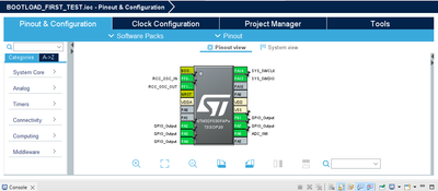

Here is the MCU IOC:

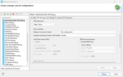

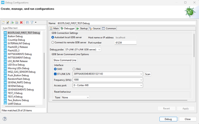

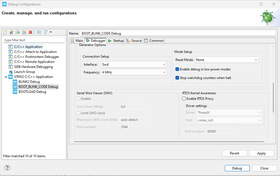

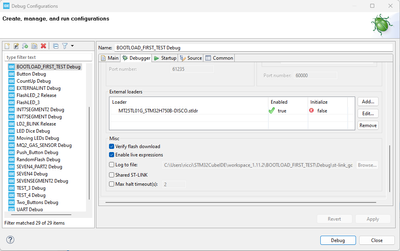

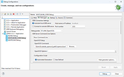

And my debugger settings:
 Any help is greatly appreciated.

Sorry, what I meant was the STM32 Cube IDE claims that the bootloader is done, but the LED on the STLINK V2 still blinks green and red back and forth despite saying the program is finished.  Pressing the resume button after bootloader doesn't seem to do have the code run successfully, and the LED on the STLINK still flashes between red and green.  As for the code, right now I just want to blink an on board test LED, the code is as follows:

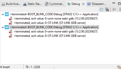

So where do I go from here? I've tried tweaking my debug settings for the ST-Link but nothing seems to work. It successfully bootloads every time and identifies the correct MCU, but this is what I get in the debug window:
I feel like its something trivial with the way I have the ide setup or possibly my clock configuration but I'm really not sure.
Don't know if this helps, but I tried a different debug configuration, and this is the result I got:
Open On-Chip Debugger 0.12.0-00029-gf77e7cb03 (2023-12-15-13:25) [https://github.com/STMicroelectronics/OpenOCD]
Licensed under GNU GPL v2
For bug reports, read
	http://openocd.org/doc/doxygen/bugs.html
Info : Listening on port 6666 for tcl connections
Info : Listening on port 4444 for telnet connections
Info : STLINK V2J45S7 (API v2) VID:PID 0483:3748
Info : Target voltage: 3.213158
Info : clock speed 1800 kHz
Info : stlink_dap_op_connect(connect)
Info : SWD DPIDR 0x0bb11477
Info : [STM32F030F4Px.cpu] Cortex-M0 r0p0 processor detected
Info : [STM32F030F4Px.cpu] target has 4 breakpoints, 2 watchpoints
Info : starting gdb server for STM32F030F4Px.cpu on 3333
Info : Listening on port 3333 for gdb connections
Info : accepting 'gdb' connection on tcp/3333
Info : device id = 0x10006444
Info : flash size = 16 KiB
Warn : GDB connection 1 on target STM32F030F4Px.cpu not halted
undefined debug reason 8 - target needs reset
Warn : GDB connection 2 on target STM32F030F4Px.cpu not halted
[STM32F030F4Px.cpu] halted due to debug-request, current mode: Thread
xPSR: 0xc1000000 pc: 0x0800060c msp: 0x20001000
Info : [STM32F030F4Px.cpu] external reset detected
shutdown command invoked
(Note: Shutdown command invoked was when I stopped the program)

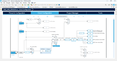

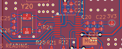

I found the solution,
the board uploads when I have the crystal set internal instead of the external setup I have but I'm not entirely sure why. I chose the ECS-80-12-30-JGN-TR with two 20pF caps at CL1 & CL2, and have Rext at 0 ohm acting as a jumper for now.
I'm not entirely sure what's causing the bootloader to essentially get stuck at the end of the cycle when uploading it, but I'm assuming it has something to do with the way I set up the crystal.
Here is the layout on the board:
