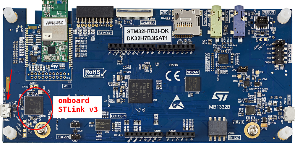

I have purchased the STM32H7B3I-DK I find that there is no power cable provided,Its just the board that is provided
I see that we need to purchse the STLINK V3 , But i see that on the Board it is USBTYPE-B connection for STLINK USB - CN14 ,But the output of the STLINKV3 does not have the usb output and need a connector
I am really confused on how the interface from
LAPTOP (USB) <-------------->STLINK<--------(INTERFACE)------> (USB PORT) <-----DEVELOPMENT BOARD------->
Can you please help on the links what all the components that i have to buy to interface this completely so on the board it will be USB input from STlink V3

Board just needs a standard Micro USB cable to connect to PC. This should not be a charging cable, as the data connectivity is required.
The board has an on board ST-LINK V3, check manual and power jumpers.​

Ensure that the JP1 jumper is set to STLK. 2. Connect a Type-A to Micro-B USB cable from the STM32H7B3I-DK board (Connect USB STLINK CN14) to a PC to power the board. Then LD5 (+5V) and LD4 (STLINK COM) light up.
