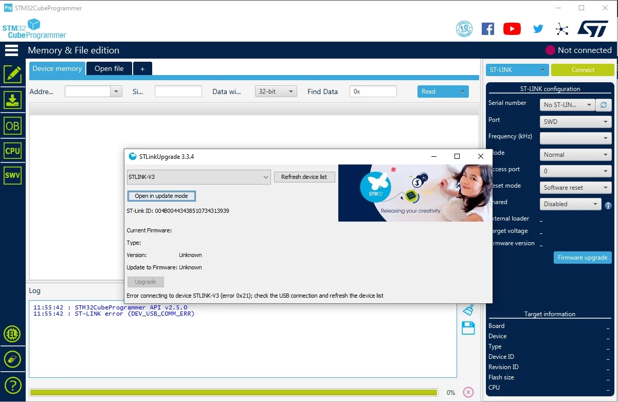

Ricky Gai
February 21, 2021
I totally cannot establish link with STLINK V3 as picture attached, just bought this ST-LINK V3SET few days ago, going to return it back in replace a new unit.
S C
February 22, 2021
Please try to run STLinkUpgrade application out of any other application context:
Ricky Gai
February 22, 2021
hi S C,
I found the issues, the ST-LINK V3SET cannot be identified under USB HUB but when I connected directly to standalone USB port it works and upgraded its firmware to latest version as I documented this morning on the thread below:
https://community.st.com/s/question/0D73W000000mz7O/detail?s1oid=00Db0000000YtG6&t=1613993186092&s1nid=0DB0X000000DYbd&emkind=chatterCommentNotification&s1uid=0053W000001o8WP&emtm=1613957158921&fromEmail=1&s1ext=0
  1. Why ST-LINK V3SET cannot work with USB HUB ?
  2. Can ST-LINK V3SET works with clone board STM32F103C8T6 ? as I am having issues connecting it successfully via STM32CubeProgrammer as mentioned on the thread link above, please have a look.
Please advise.
Thank you.
S C
February 22, 2021
  1. Please ensure your hub supports USB High Speed, because the STLINK-V3SET does not support the Full Speed mode. That's the first reason I can imagine. There is no specific driver for STLINK-V3 on Windows, it relies on WinUSB (= Windows native) for debug and bridge interfaces, standard mass storage and Virtual COM port drivers.
  2. What are you calling "clone board STM32F103C8T6" ? If it is made with a genuine STM32 you should have no issue: check the power, the JTAG/SWD connection, the target reset and try different connection modes. Otherwise I have no idea and no way to check

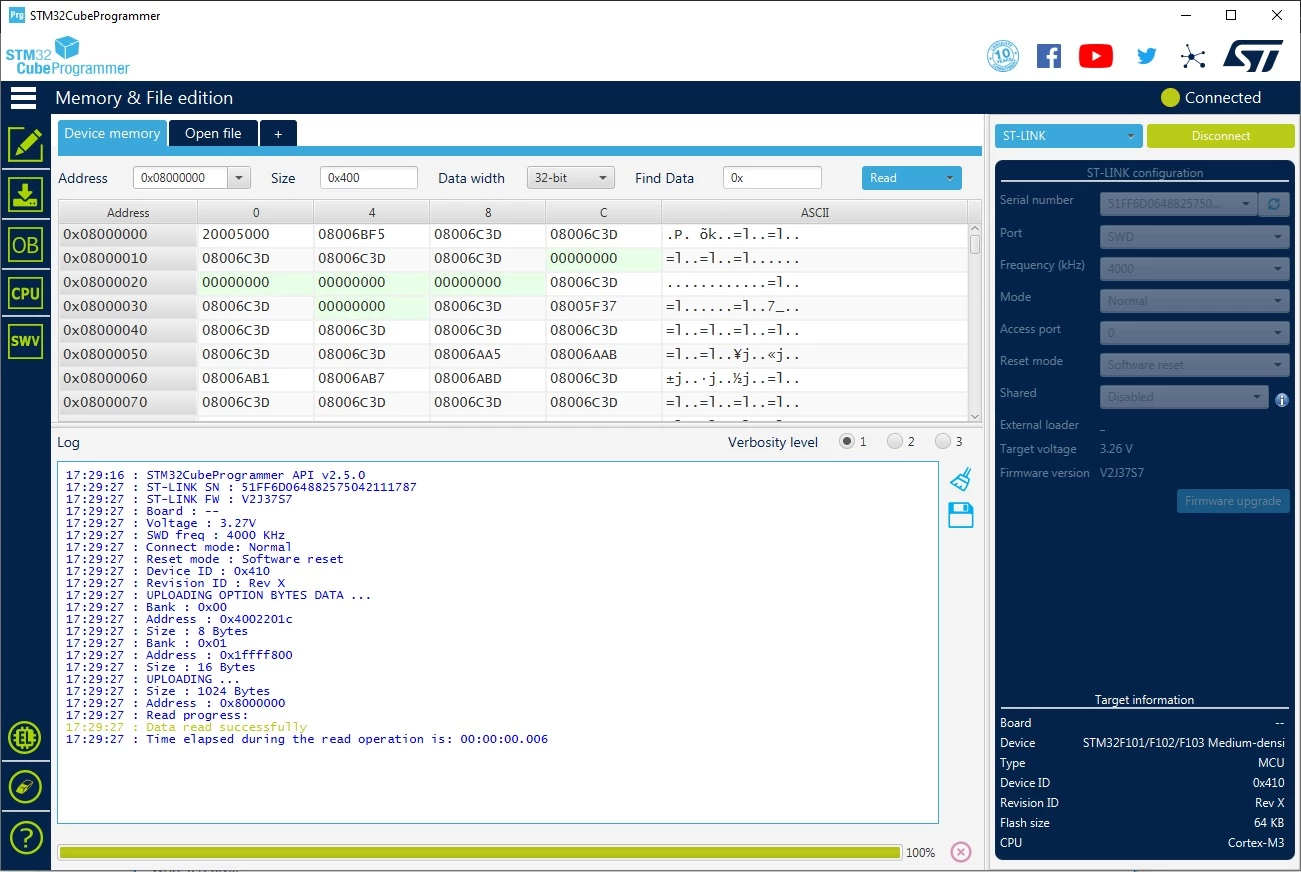

Ricky Gai
February 23, 2021
hi S C,
Thanks for the feedback, I used ST-LINK V2 able to connect three STM32F103C8T6 clone boards successfully shown below:
0693W000007ZByZQAW.jpgI already ordered NUCLEO-F103RB last week, as there is no stock available, I need to wait until March 2021.
I can accept the said of none genuine STM32F103 used here, because two of them are labelled CKS32F103C8T6 and remaining is labelled with ST logo but all three can be connected via ST-LINK V2 but not ST-LINK V3SET.
Well, since STMicroelectronics mentioned on its product website that ST-LINK V3SET support STM32 MCUs it seems there are more stories behind though which I really have to return this product.
