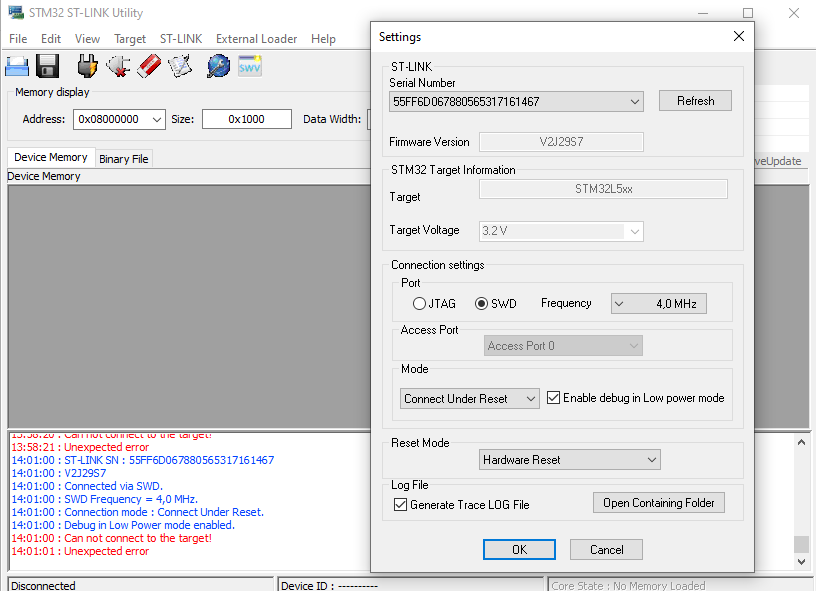

Hi All,
I have a ST link V2 and STM32L562CET6 boards. I tried all possible solution available online but still cant connect to MCU. STlink has the latest firmware.
  1. My board is good because i can program it using segger programmer
  2. wiring between stlink and kit is good because stlink can detect the MCU
i am using these connections
1.VDD-3.3V
2.SWDIO
3.SWCLK
4.GND
5.NRST
tried on 3 new units and none of them will connect.
Boot 0 is pulled low.
any help will be appreciated.
Thanks
Does ST-LINK Utilities support the L5 parts? The software's deprecated, try using the STM32 Cube Programmer software

Linas L
Senior II
Never had problems with L5.
Does it really have firmware ? If yes,it can be in low power or badly configured. Reboot with boot pin high. It should connect them
Also reset if connection is correct to pa13-14 pins​
ABhas.1
thanks for quick response
i tired with boot0 high but didnt help.
i tired the units which are never programmed and they are showing same behavior.
By default the reset pin is pulled high. i tried with pulling it low and connecting and erasing but didnt help either.
ABhas.1
@Community member​ i owe you a beer :)
